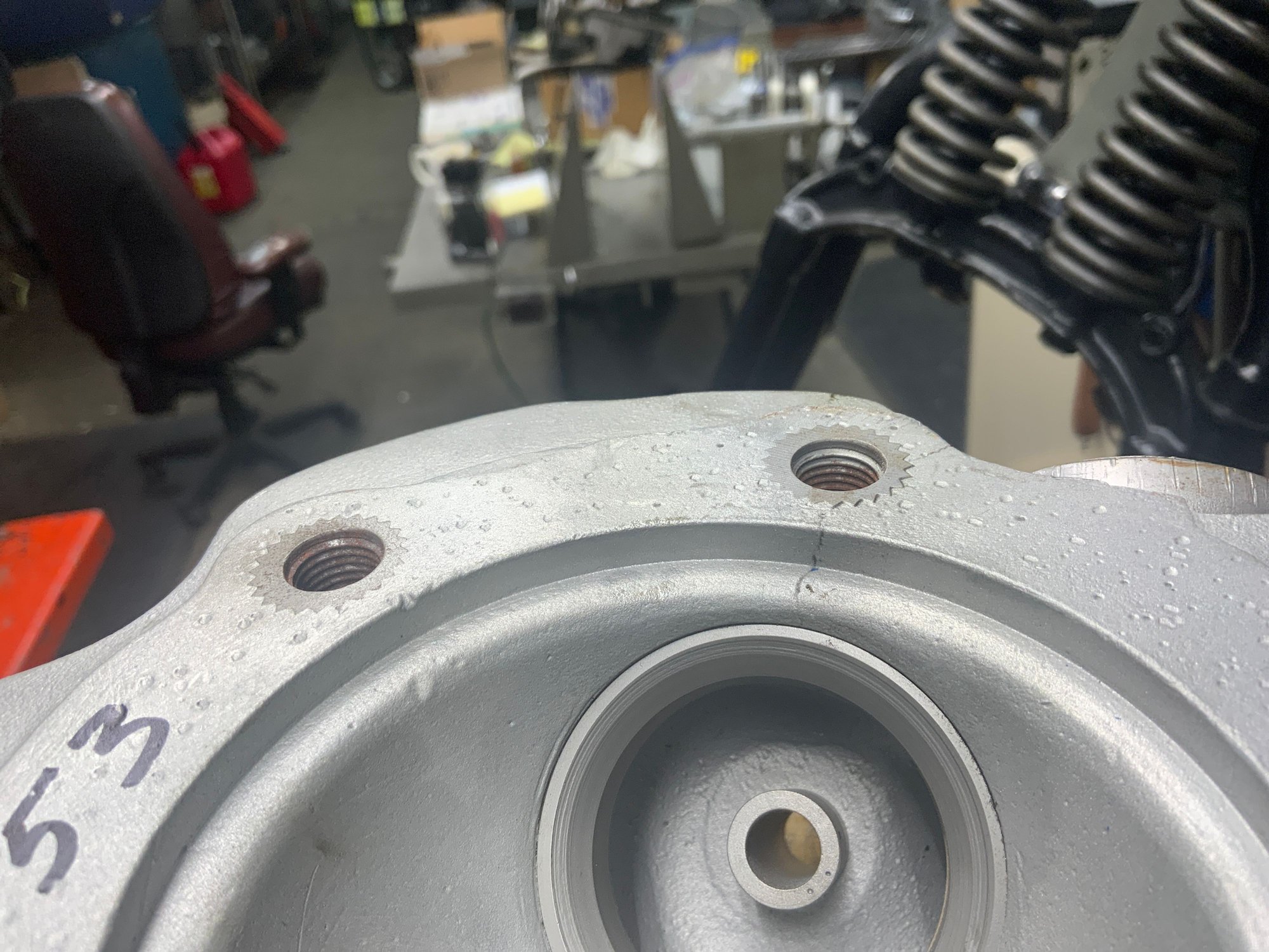

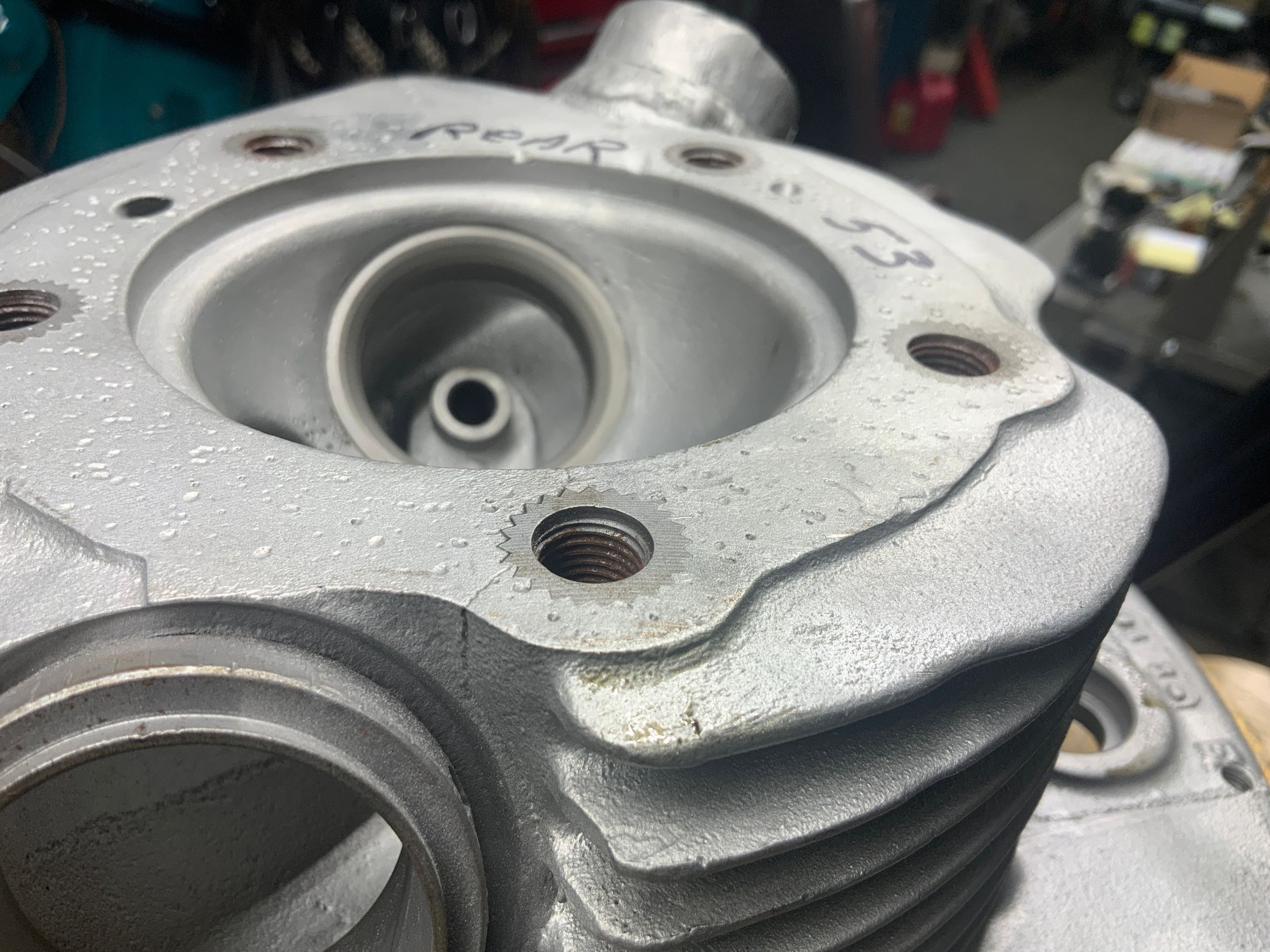

when the ARP stuff first showed up it was all the rage - now most shops have a knuckle drager pulling wrenches - finesse is a pipe wrench - the casted in sockets in the pan heads were being pulled out - knuckles were 7/16X16 thread and heli coils were not available yet - yet the heads were not expensive like today - we found a happy middle ground - sure been doing it how many 10,000 sets - have a pan head that is cracked from the intake post to the valve seat through the bolt socket you can see it lifted just a bit but that is all it takes - will picture it up and yes something was on the the bolt and thread - dont know what it was but my guess could be

While its wet it make a difference - tried it with out and the bolt can chatter before its torque is achieved - a rice crispy thing snap crackle and pop - and then it evaporates
been do it this way too long with no issues to learn NOW how to wear a dress
