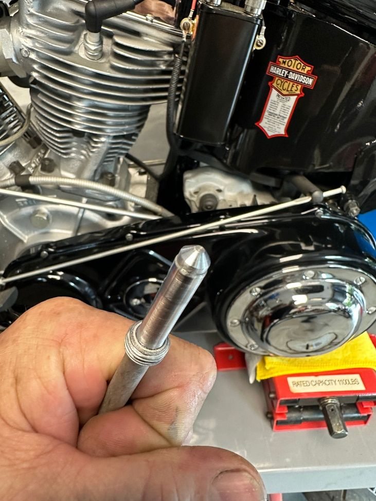

Drain the tank and undo the large nut on the bottom of the left tank. The shut off rod goes down through the bottom hole once you remove the **** and lower nut (fitting). The fitting is the seat, the rod is the needle. See if the tip is steel, viton or missing all together.

Look after the shutoff first and then see if the carb needs rebuilding.
Here is the shutoff from my 48 EL. The original ones are steel, repop have a viton tip that can come off. I had one come off after the first time I used it. My 48 shutoff was leaking and filling the carb up then leaking down onto the engine. Rather than go repop I refinished the tip and now it seals perfectly.
