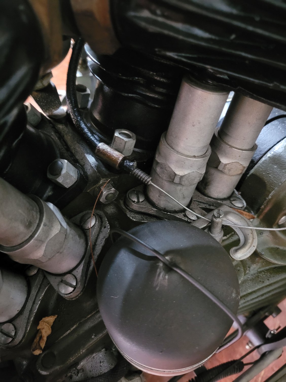

I have added some pics of what I have.

Hi so for starters you do NOT need to remove the cylinder, you will need to remove the front cylinder rear nut on the valve side to mount the timer cable clamp underneath it. The cable should come out of the left side of the handlebars and come down the left side under the tank and between the cylinders.

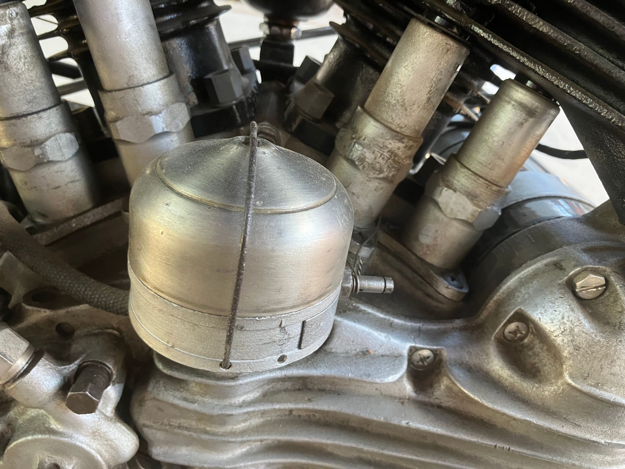

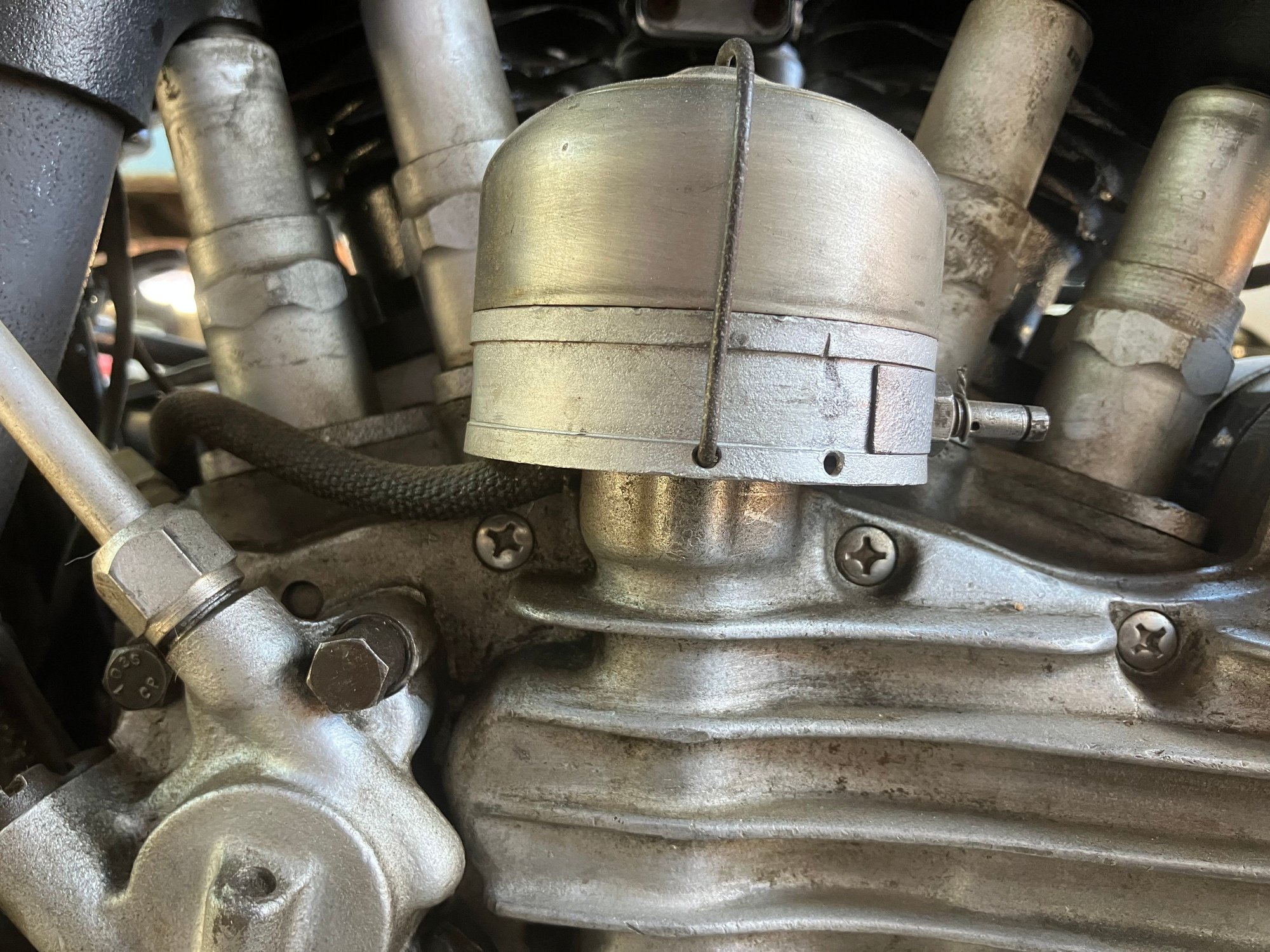

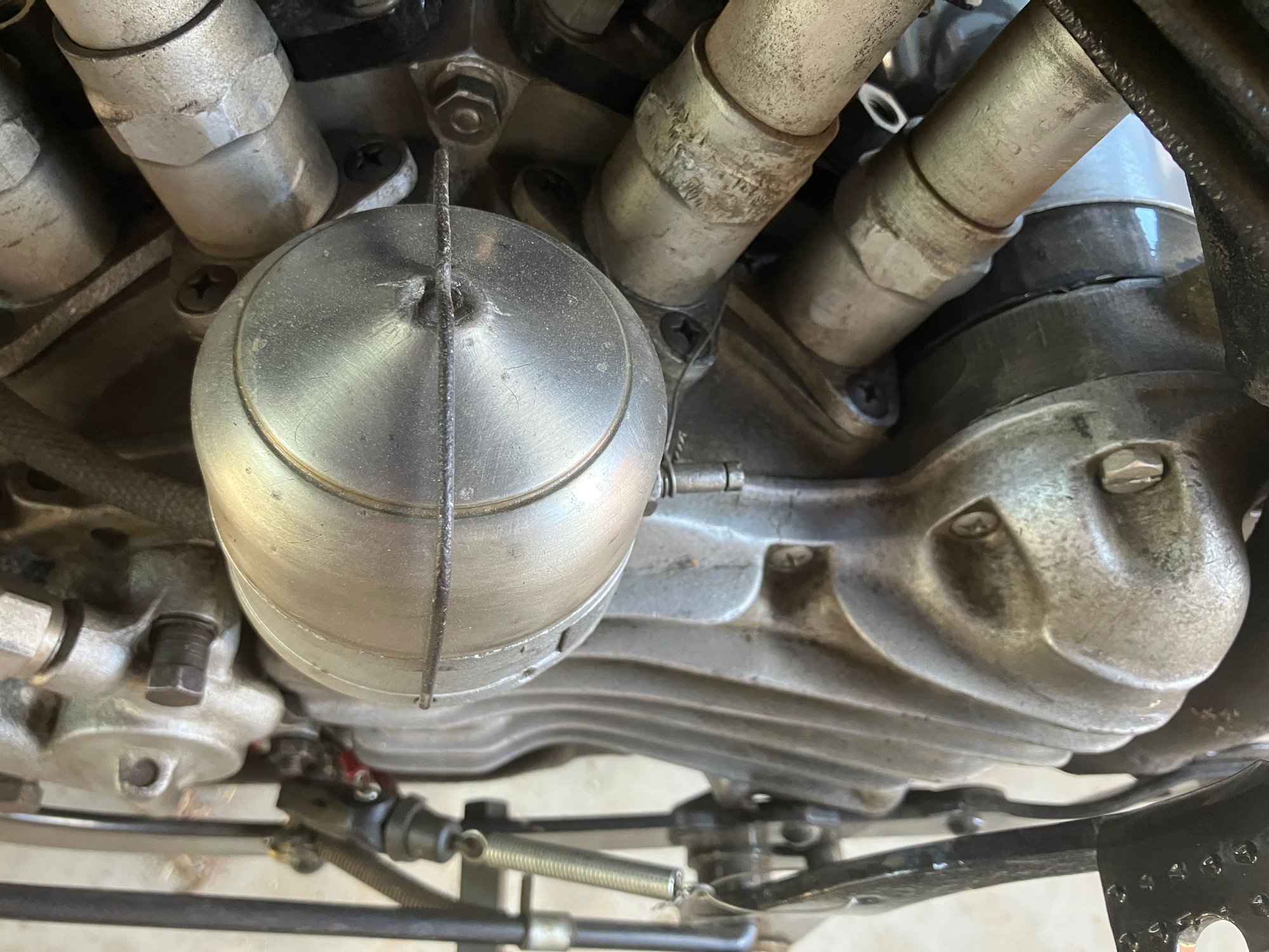

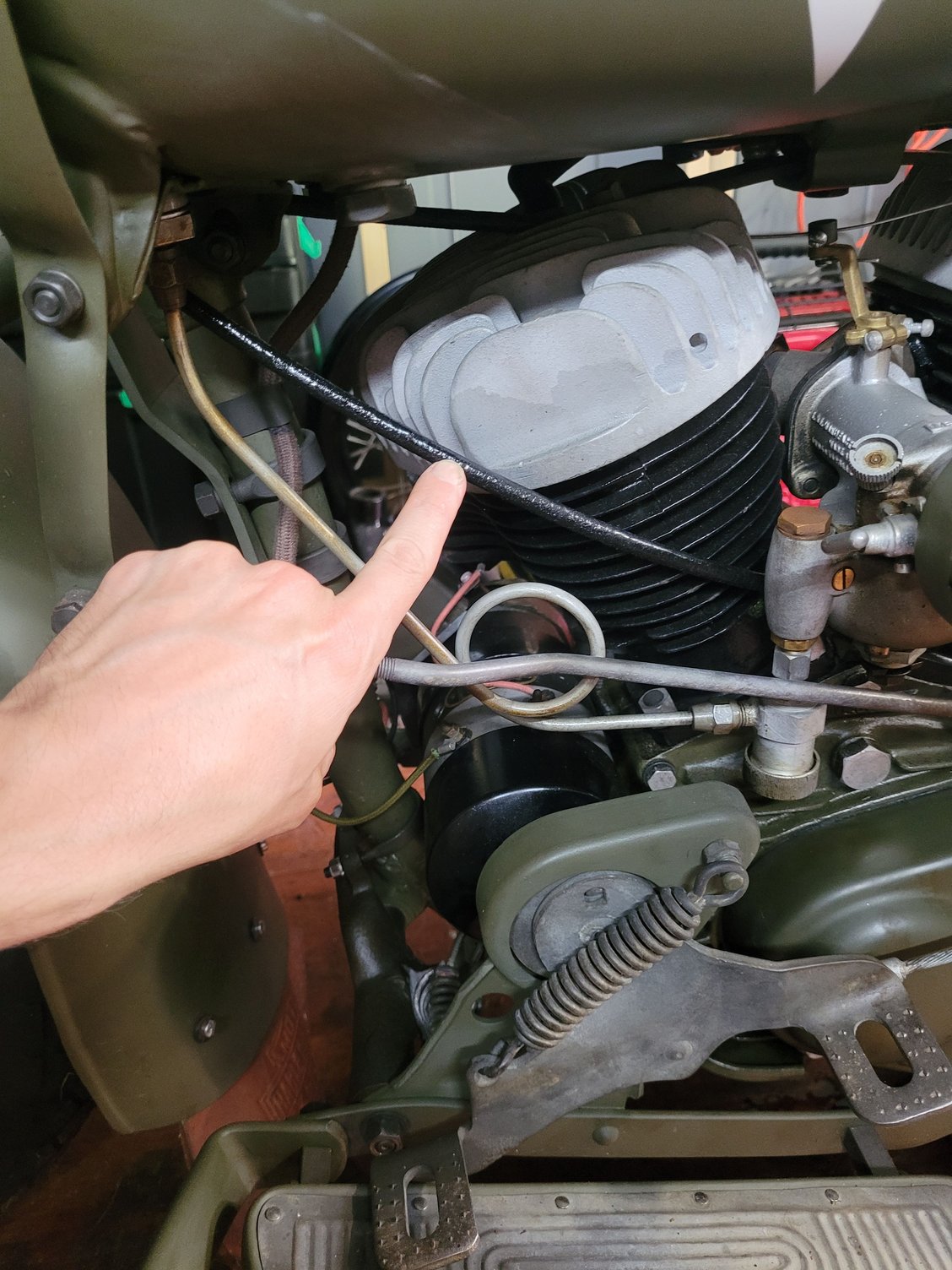

No problem I can add pictures of how my cable is run later today.

Old Sep 5, 2025 | 02:37 PM

Old Sep 5, 2025 | 03:23 PM
Revvin’ Kevin's Avatar
Revvin’ Kevin
Joined: Sep 2025
Posts: 42
Likes: 22
From: AZ, USA

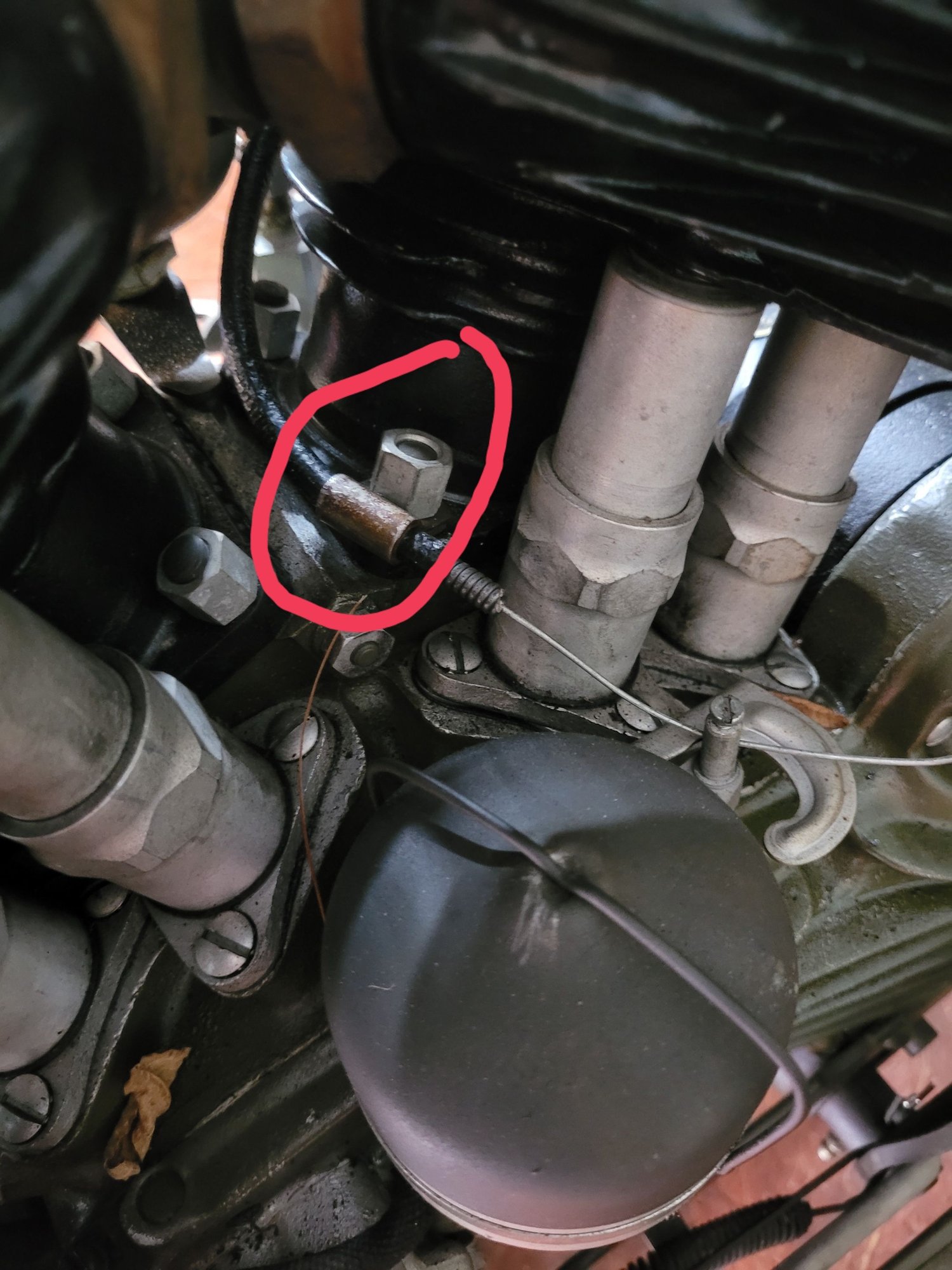

Thanks for the pics.
Yours is a WLA (nice ride, BTW).
That bracket set-up appears to be the early style, up until ’46, and I don’t believe mine is supposed to have that.
I do however have the hole in the tab (though it lays horizontally as opposed to vertically like yours, as depicted in my picture) and the hole doesn’t go all the way thru.
Sure seems like I just need thst clamp and the cable, though.
Thanks again for the info. Hoping my parts manual gets here soon so i can confirm my particular era’s set-up, but it looks cut and dry.

Yes your's appears to be a 47up set up so the bracket under the tappet block you don't need your stop will be internal on the timer base.
The bracket you need is to hold the cable in place.

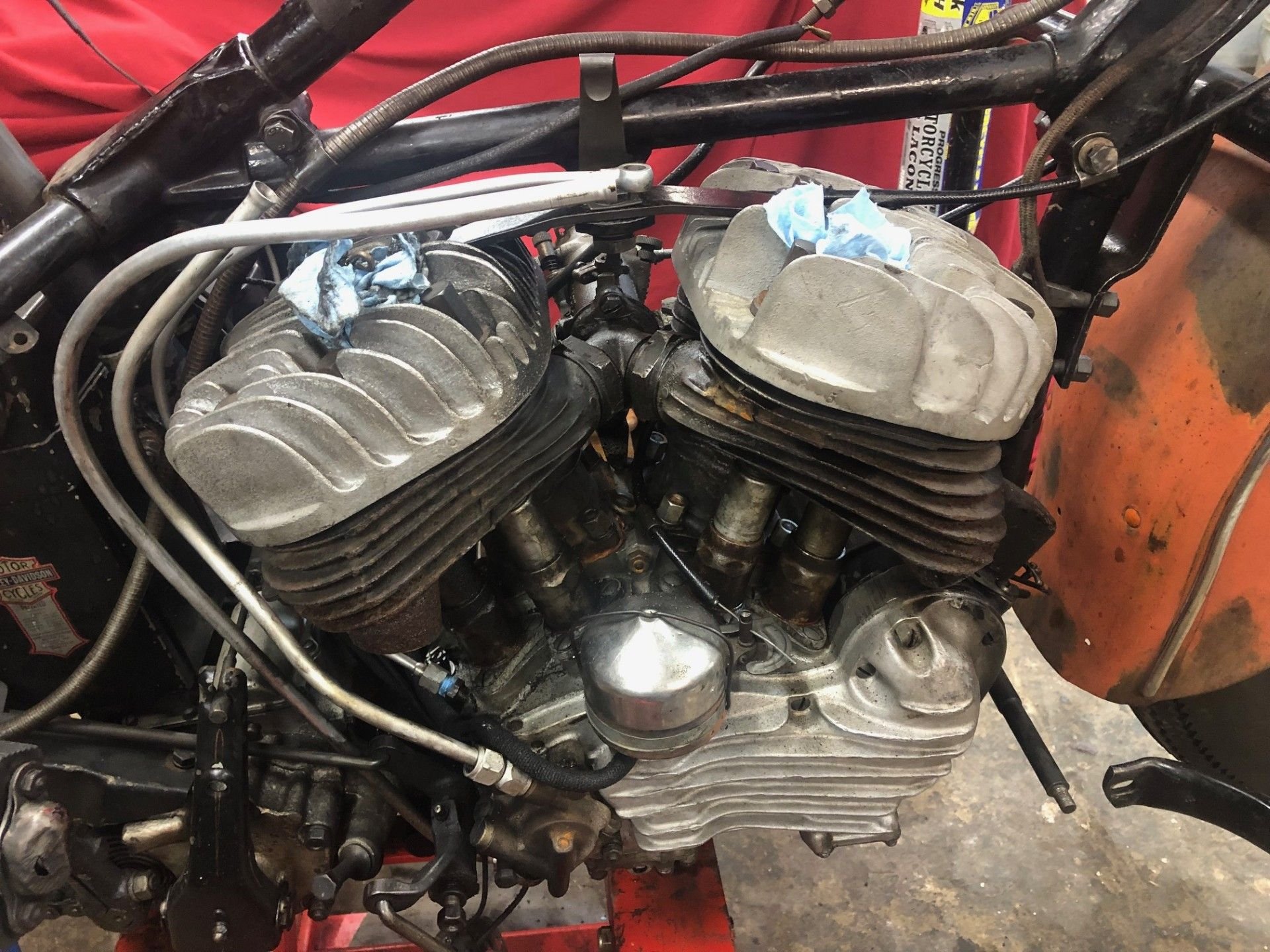

All previous info provided is spot on, picture of the same setup on my 1946 for reference. The cable bracket is mandatory, the other guide bracket that mounts to the tappet block is nice but not needed. I ran for years without one, just added it when I had the motor hopped up and it was all apart anyway.
