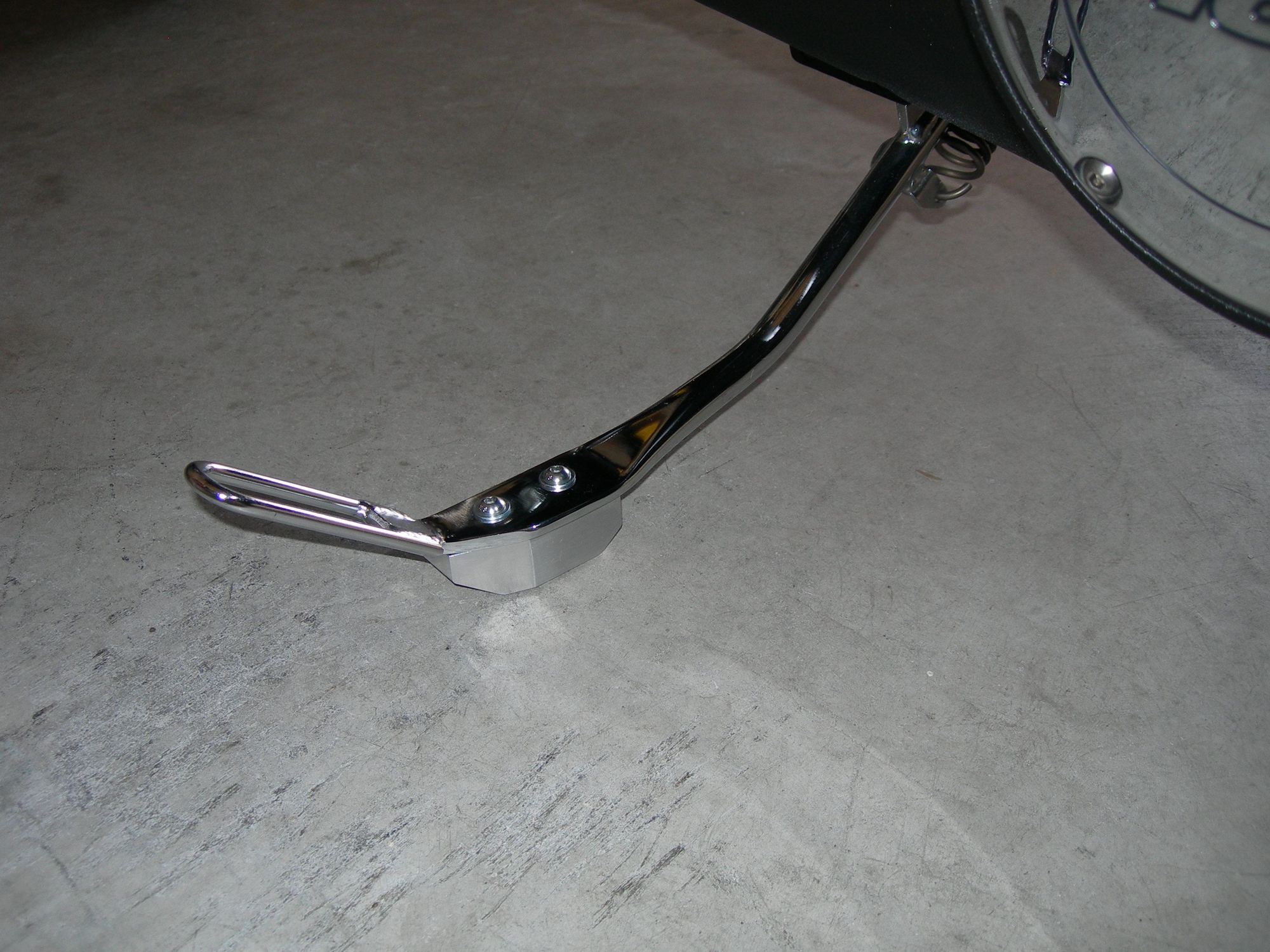

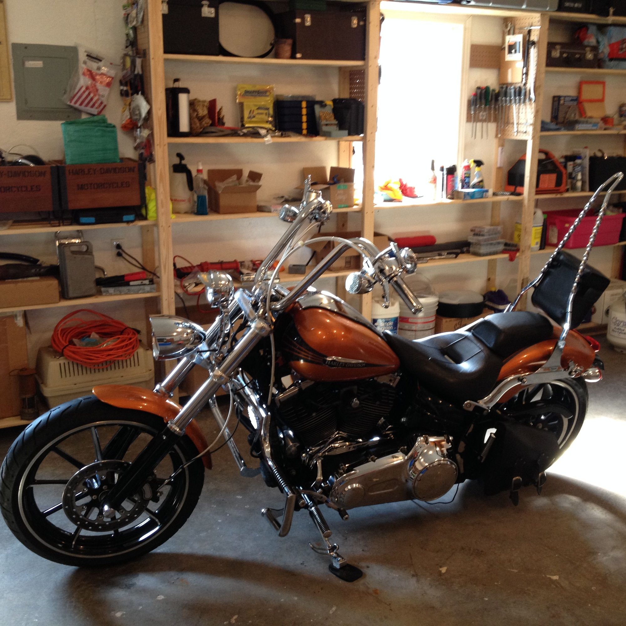

Hey TinCupChalice !!
I couldn't get photos to attach to my PM so in response to your last,, here are some pics:

Nice! If you hit the fork tubes with Turtle Wax Chrome Polish and Rust Remover those subtle marks left on the tubes from the previous clamp positions will polish right out; took just a few minutes to get my tubes gleaming

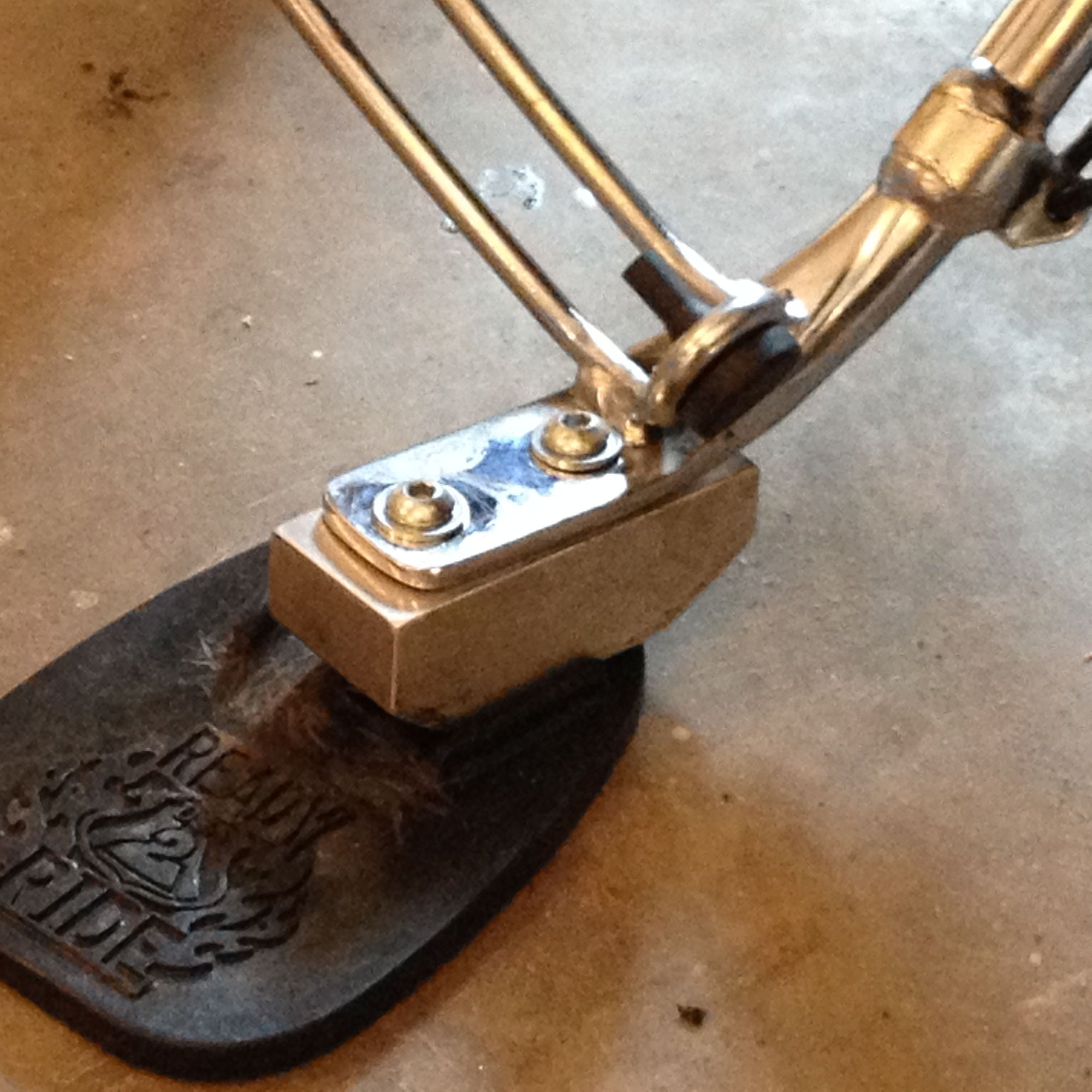

Next up for me, the jiffy extension!

Longer tubes, higher heels
