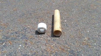

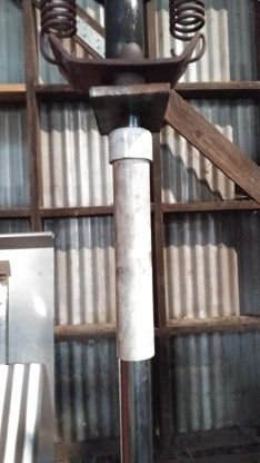

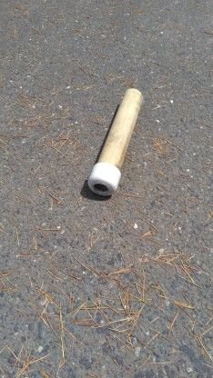

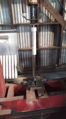

So I rebuilt some 41mm 2000 Softail forks and found that they're of the type that can't be compressed by hand in order to get everything back in place and the top caps screwed down. I saw that some tools are available but proceeded to use an H-frame press with my own "specialty" tool, made of some old thin wall 1.5" PVC pipe plus end cap with a 1" hole drilled through. That set up was able to contain the spacers and fork tube cap while compressing the springs, still allowing me to turn the cap. Also, being able to separate the two PVC parts allowed me to assess the position of the cap in the meanwhile. Maybe nothing new-new to me anyway.
