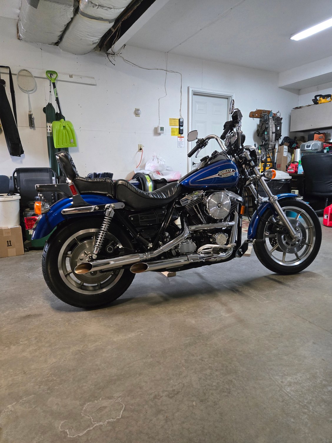

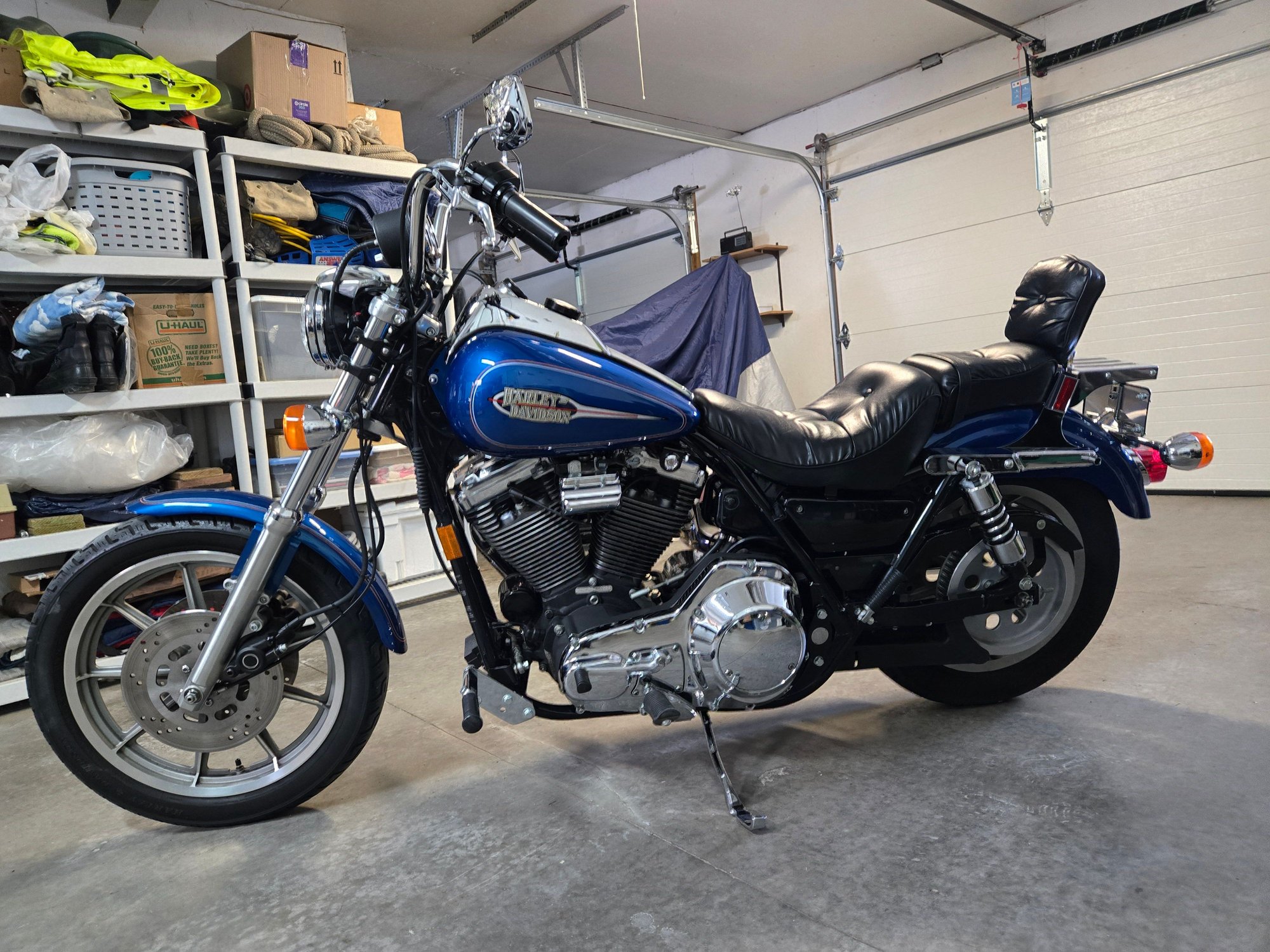

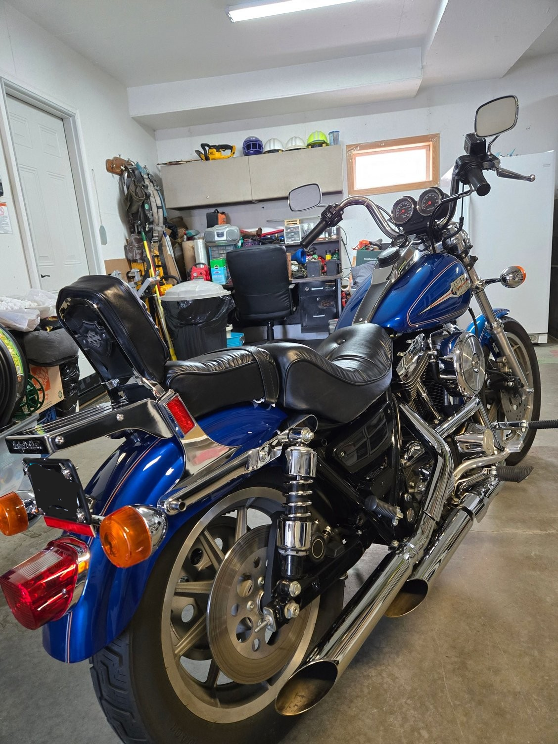

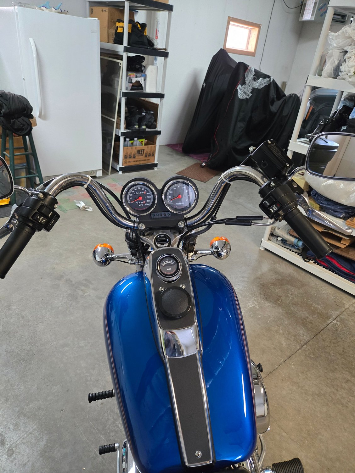

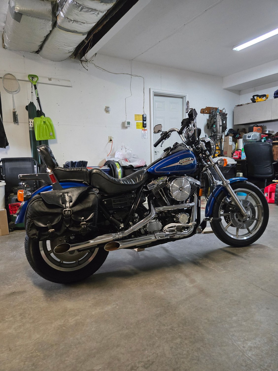

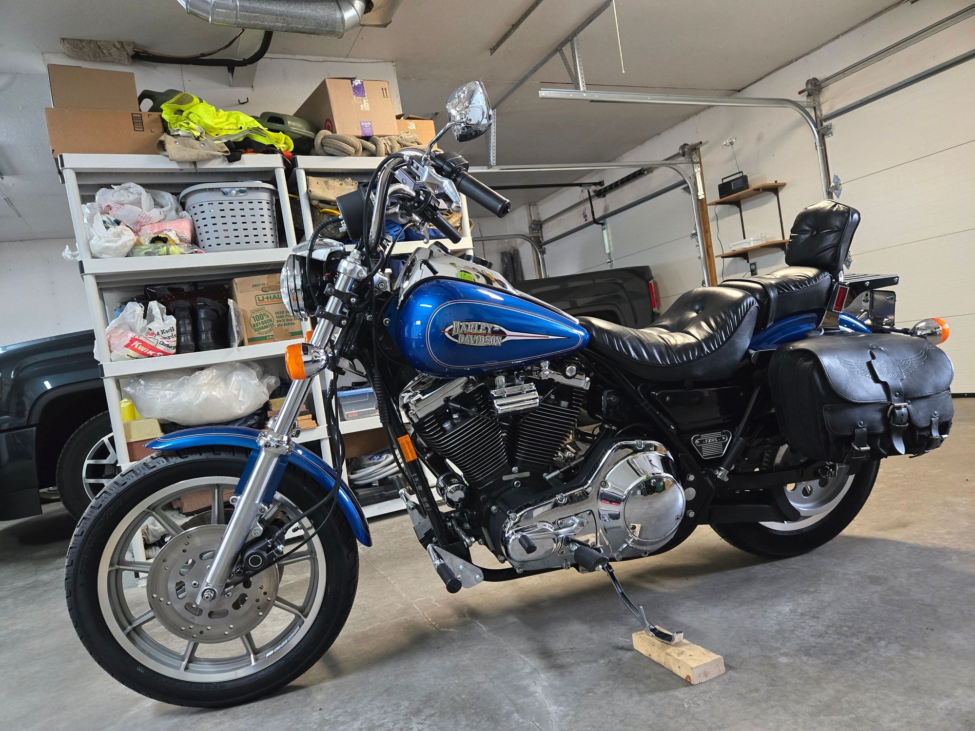

This is a 1993 fxrs-convertible that I recently acquired. Nearly completely stock except for the lower progressives on the rear and the exhaust slip ons. Has factory air on the front end. It came with the removable windshield, original 12" shocks (which I plan to put back on), original mufflers and the saddlebags with hardware. Keeping this bike close to stock as thats how it should be with survivors like this. The low progressives in the rear prevent using the saddlebags as the right side would burn up on the exhaust. A question I have is would 13 or 14" shocks keep the bags off the exhaust better than the 12"? Would the ride and handling be better with the 13 or14"?

I was mistaken when I said the original shocks that came with the bike in a box were 12.5". Actually they are 14" so Im planning on using them.

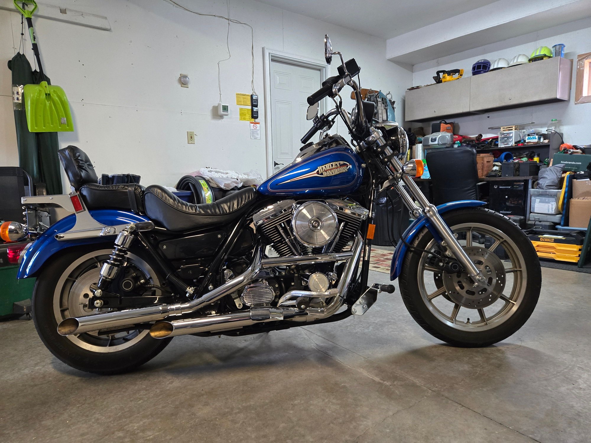

Its now raised back up with the original shocks.

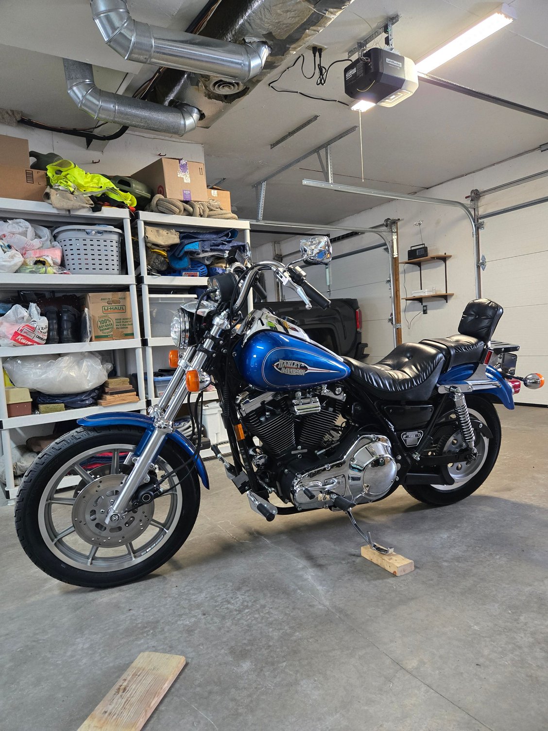

Replaced the INA cam bearing with a Koyo (Torrington) bearing and added an Andrews EV27 cam.
