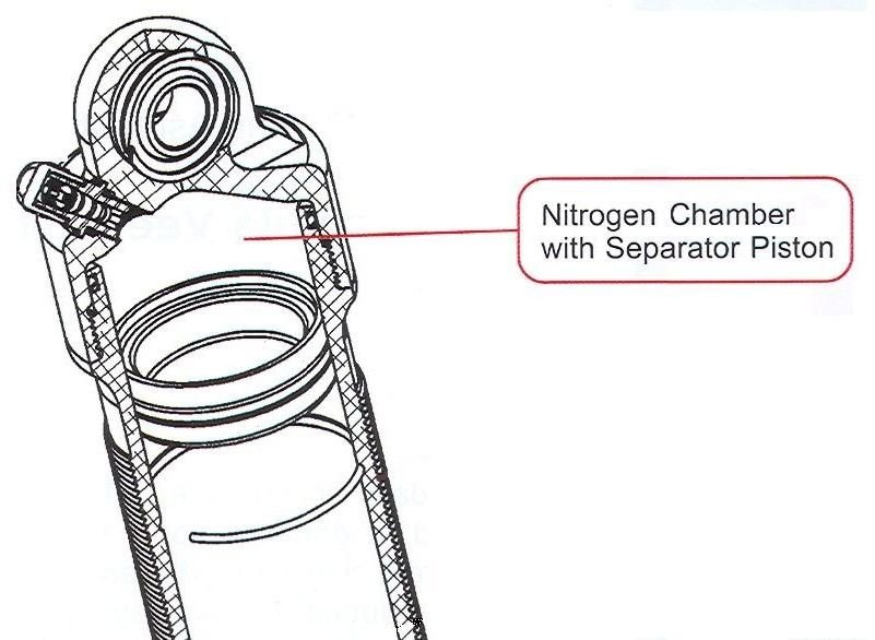

On to "How It Works"
The way the swing arm works is a pull type shock much like a Buell which to seem to work fairly well.

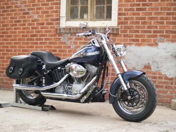

There are 2 members on the HDF forum who purchased these Softail Ohlins (2005 era) for their bike, Buda was one but as many HD owners come & go over the years and another one who located a pair of pre-owned in Istanbul, Turkey. It is very puzzling how HDF members who actually own and ride these shocks posted their Ohlins Softail experience, which was entirely different than the assessment member Next In Line posted. I do not know everything but once Next In Line posts his findings and proof, we than all can evaluate what is correct and what is just Internet worthless drivel. I want to know as many here would also like to know what is fact and what is not.
The Ohlins shocks are re-buildable so they are lifetime shocks as all parts are available from Ohlins or from a certified service center. These are nothing more than a divided piston (separated) that can be made for compression & rebound adjustable just like I did on my #3-#3 series shocks.
These shocks employ the exact same technology as the (Below) #3 series shocks found on so many Harleys I have done over the years. The only difference is Softail shocks work in reverse. They pull for compression in place of push against the spring.
The new generation will have better drain holes in the spring cover and is more developed. At the time of manufacture most Softail owners were more interested in Chrome & Paint than riding. These first generation shocks used, when they came up for sale & demanded a large premium when purchasing them used. Due to the small amount of sales Ohlins dropped the line and support for the Softail. Ohlins now sees the demand for Harley suspension as more and more riders get educated and more & more riders actually understand why a good riding bike is beneficial to them. This is the first generation of HD shocks.
I personally have modified/manufactured several major suspension products for Softails over the years and have found that real suspension greatly enhances the ride & handling of the bike.
