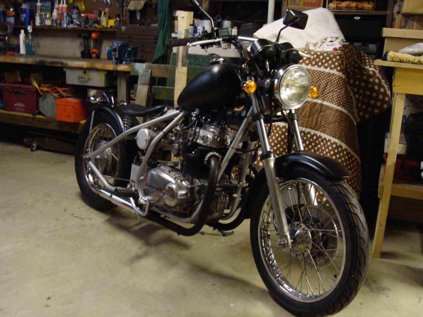

Another good direction I see for that bike is to turn it into a bobber. Here is a pic of the same bike bobbed out

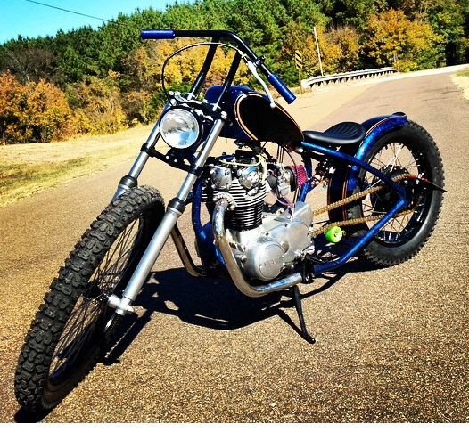

My Sons first ground up build a couple of years ago was a Bobber based around a late 70s Yami XS650 power train. He found the XS650, pulled the drive train and parted out the bike. Dropped the engine into a Voodoo Vintage frame and fabricated the rest.

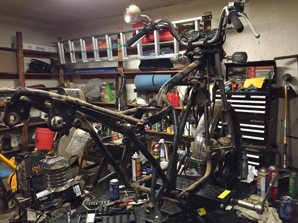

Oh I am going to have fun with it. Started the abandoned vehicle possesory lien paperwork yesterday.
Here is what it looks like right now.
This is the basic shape I am going for. With some changes.
Going with round strut's, the flat ones look cool but, but flex side to side.
Planning to run 16"apes rather than drags, no gauges, just a head light and tail light.
Ditching the CV carbs, they will never run right with a pod and straight pipes, found a guy who makes gorgeous tig welded manifolds to run a single carb set up. I'm going to run a single Mikuni VM34.
Going metallic toxic green with the frame, black tank with the same toxic green paint inserts on the side of the tank and going to gold leaf "KZ440" on the side of the tank.
