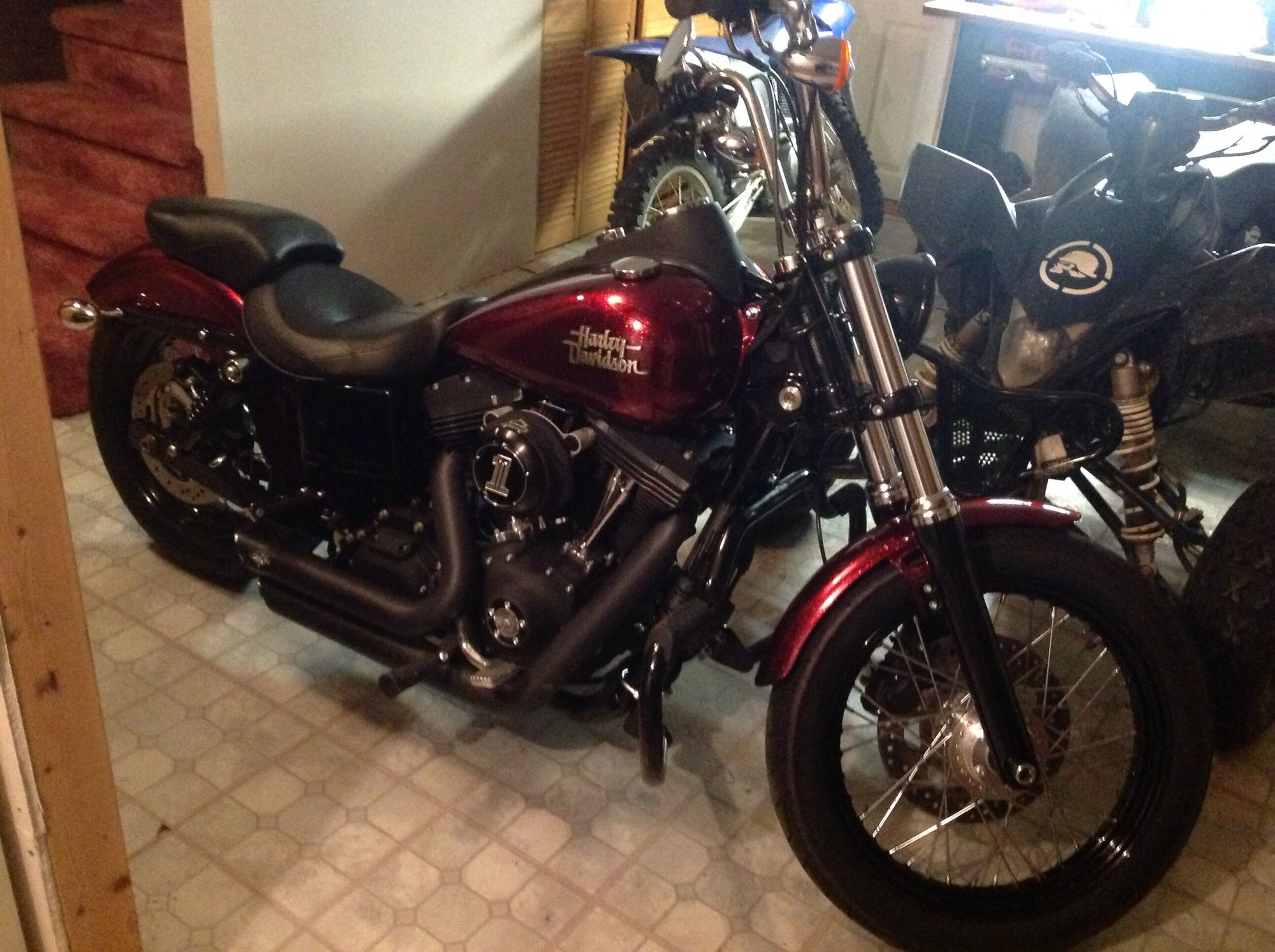

As I said in the OP, my bike came with V/H short shots...I'm not sure if it came with the stage 1 tune or not (not even really sure what that is...other then just remapping the fuel injection with one of those computer things, and swapping out the air filter for a higher flowing one...but I thought that was necessary to do anyway once you replace the stock exhaust with freer flowing pipes).
I kinda just want to add a toolkit and a bag of some sort so I can carry stuff in. I like to keep mine with the "blacked out" look:
But after reading this thread, I'm now thinking "hmm..that sounds kinda cool, maybe I could do this and that...and that" Haha.
Judging by your pipes and the intake on your bike if it doesn't pop like crazy on deceleration your bike has been remapped and you have a stage one. Rule of thumb is you can swap pipes OR intake alone without a retune. However when you replace both you should (some say must) retune.

Nice thanks!
There is some popping on decel, but not a whole lot.
