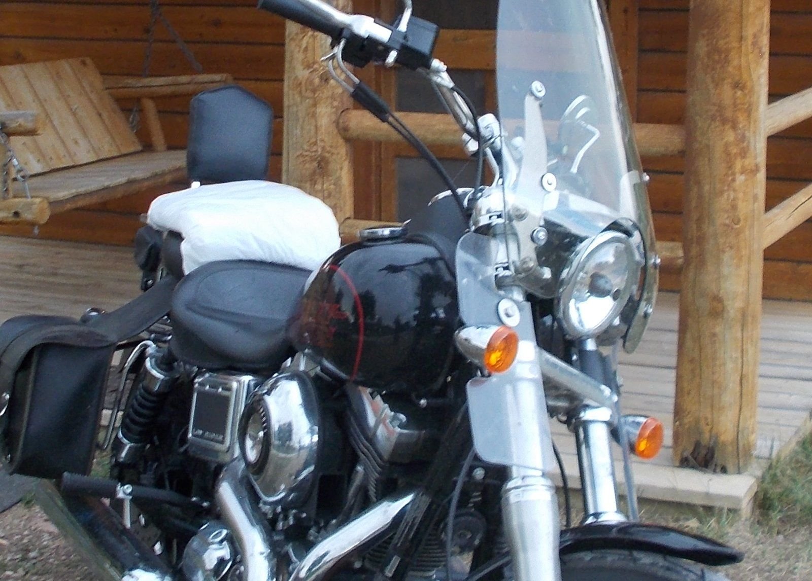

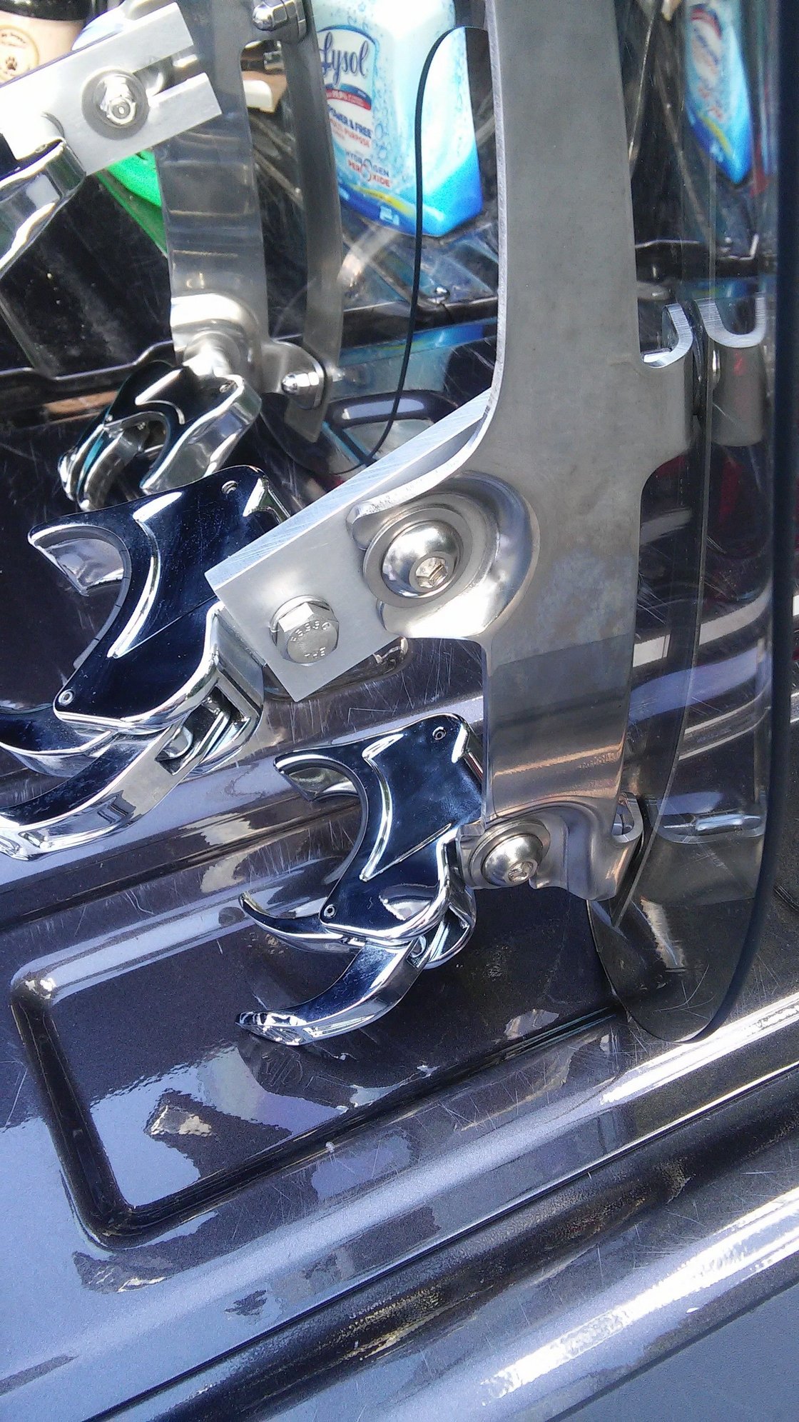

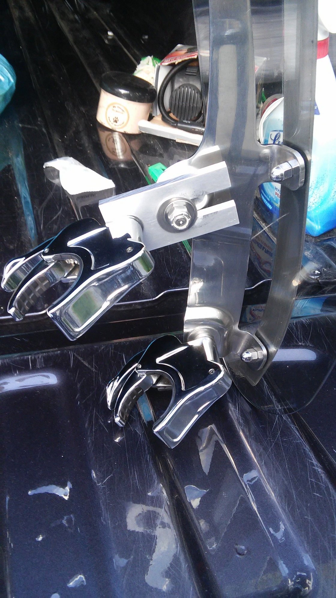

I have heard and read of so many cures to eliminate or reduce the notorious "buffeting" associated with wind screens, I had to try and see for myself. I have the HD Compact wind screen for my SGC which has about 2" of travel on the 49mm forks. So I had a couple brackets made up to kick the lower end of the wind screen out about 2" to increase the angle. Tried multiple runs at 60+ mph sliding the screen up and down on the forks.
Results: My head wasn`t bobbing all over the place but it was a constant shaking like a paint can mixer but not that extreme.
So then I switched the brackets to the top to kick out the top of the wind screen and of course made multiple runs while sliding the screen up and down the forks.
Results: Way worse than angled at the bottom and also worse than the normal mounts.
So I realize that the air comes up from the bottom and around the tank but I thought I would give this a try. I`m only out $40.00 bucks for the brackets and who knows, maybe those with the addition of lowers or something else, the buffeting can be reduced or eliminated.
