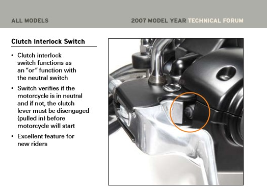

The newer Harleys won't engage the starter in gear, they have a clutch interlock. Somebody help me out here; 2007 and up??? Even when the switch goes bad it won't do it. It'll only start in neutral then.

For once I was right! Starting 2017 with a bang
