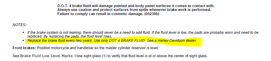

that's standard with hygroscopic DOT 4 fluid, pretty sure it's in the owners and service manuals too....
yup:
wonder why they sent the letter... ??
must have been some numbskull running around with 10 year old brake fluid trying to sue. "NOBODY TOLD ME!"
