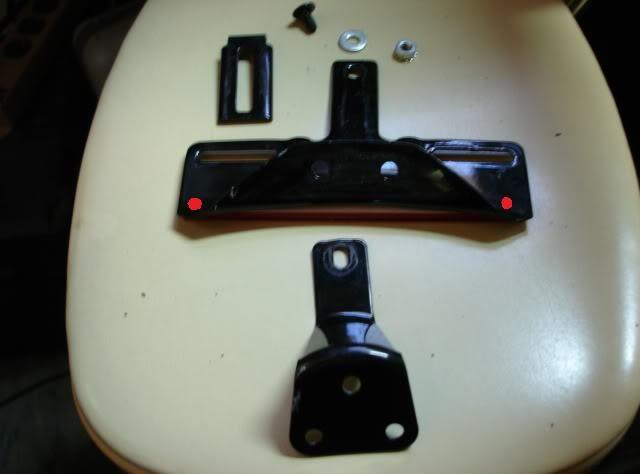

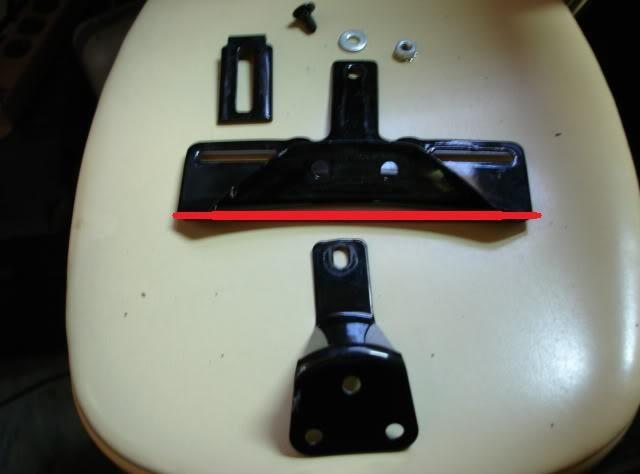

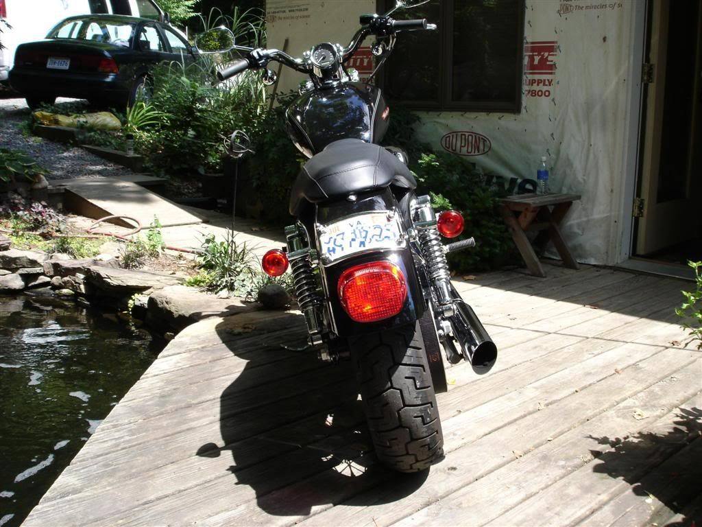

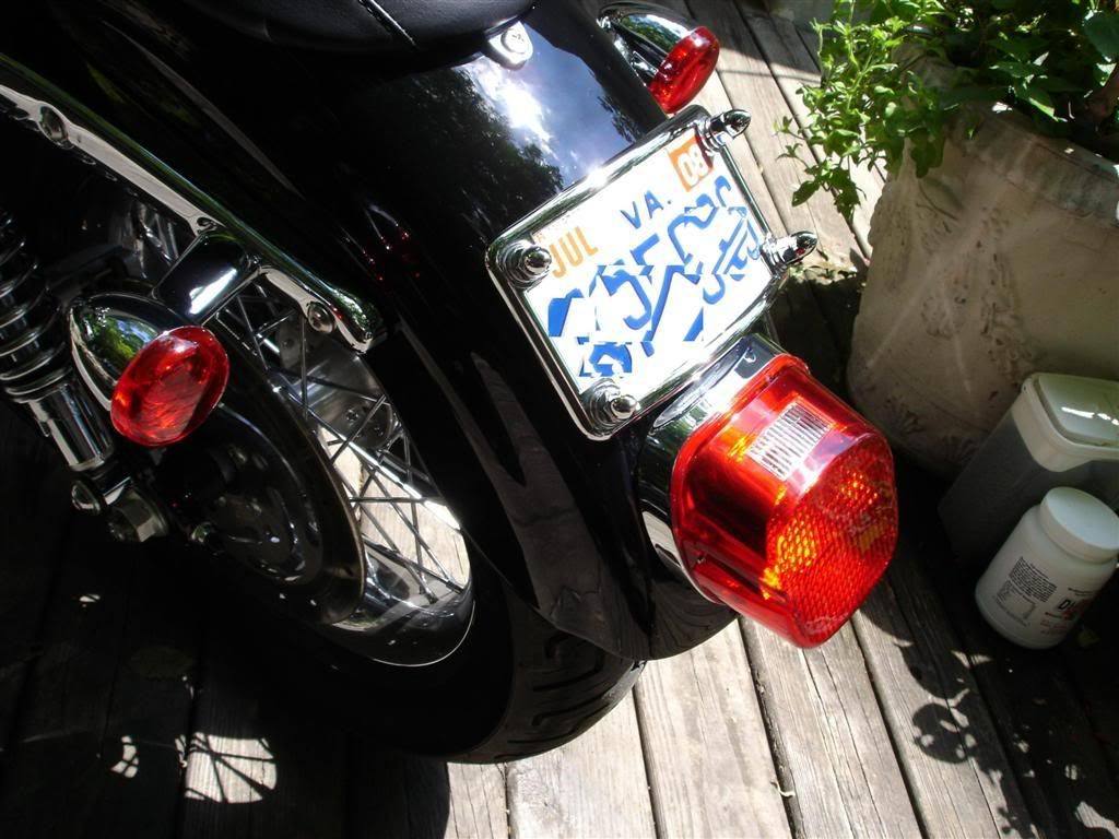

I cut my factory plate-mount bracket to the bare essentials and formed the radius of my plate around the telephone pole in the street. Rubber grommets, in the factory fender holes, keeps the modified bracket off my paint.
Cut and drill. Fasteners, of choice.
Cut line:
Drill a couple holes for the plate, and a couple holes to mount to the fender (not indicated in pic):

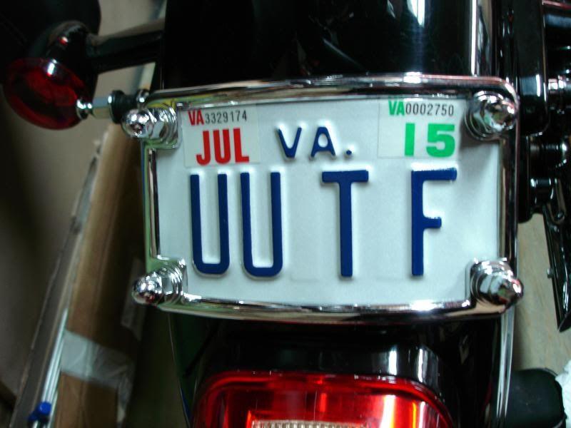

Cheap license frame, bent on the same telephone pole as the plate. I like acorn nuts:
Old pics:

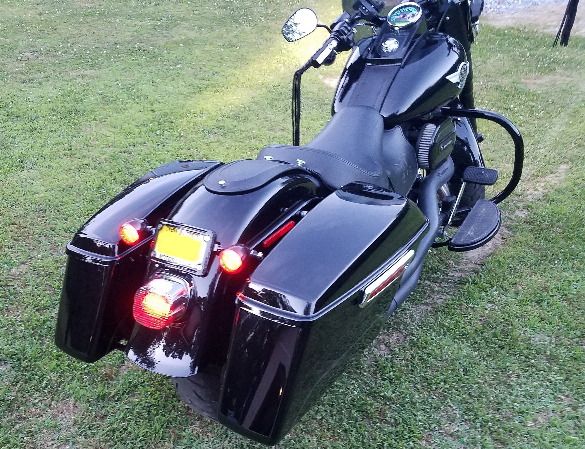

Yes a 16 Fat Boy S. As long as you have the 3 hole plate holder on yours, it should work? They are a little pricey, but I just couldn't stand the vertical bracket which comes stock. I ended up mounting my turn signals on it as well using only 2 of the holes for screws and the 3rd for wires in order to mount hard bags.
Picture shown with the turn signal relocation

That looks fantastic. It's exactly the look I'm going for, and yes, the fender mounting is 3-hole.

The only thing to consider then, is where your current blinkers are located and if you ever plan on bags which might require a relocation kit. There are some other other options on the market which address this, but are not as easy on the eyes as the Kuryakyn mount. It does come with the mounting hardware which I exchanged for all stainless steel and nylock nuts. I did a lot of research on this and couldn't find as many options as I thought there would be. Harley doesn't have any options available currently for a simple lay down plate unless it is touring. You do have to have a certain size LP which I don't know if all states are the same size or not? You should have seen my temp plate when I bought the bike. It was crazy big!
