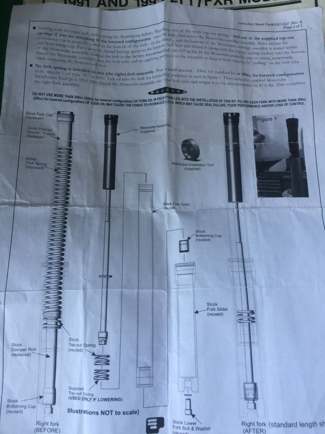

I installed the monotubes in my '12 Fatboy when I went with the chrome front end kit. Really improved the brake dive and I feel the ride is improved considerably. An added plus is not having to change the oil.
Attached Thumbnails Progressive fork inserts-img_3088.jpg   Progressive fork inserts-img_3089.jpg   Progressive fork inserts-img_3096.jpg
