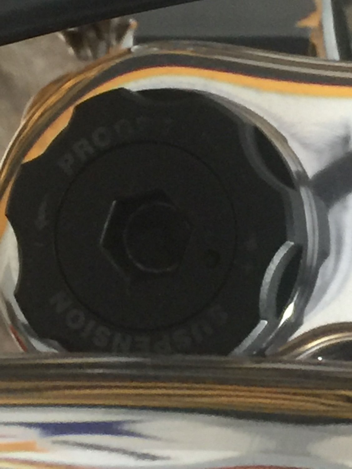

I had the progressive cartridges installed on my dyna with 444 rears and alloy art stabilizer’s. The cartrige set is better than stock, how much? Hard to say. I did not have much of a brake dive problem with the stock set up so no gain there. I don’t have to change fork oil, that’s a plus I guess. They are externally adjustable. The bike handles great with the set up I am running. Not a night and day difference but I want my my bike to handle the best it can so I would do it again if that bridge came.
