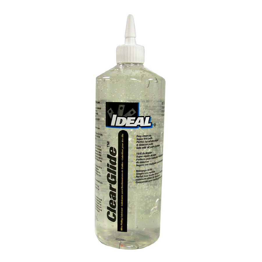

Mine aren't meat hook style, But I used this grease when I pulled mine and it made a big difference. I also used weed wacker string as my pulling string on both my bikes and that seemed to work the best. Good luck.

Originally Posted by big papa AZ
Great stuff and does not degrade the insulation. Some stuff you use on the wires will degrade the insulation.You dont "need" allot of any kind of lube nor do you want allot in there afterwards.
Like someone said, have the bars tightened in the clamp or a vise or something. It will make it much easier. (You didnt say if you did or not, so I am just mentioning it.)
