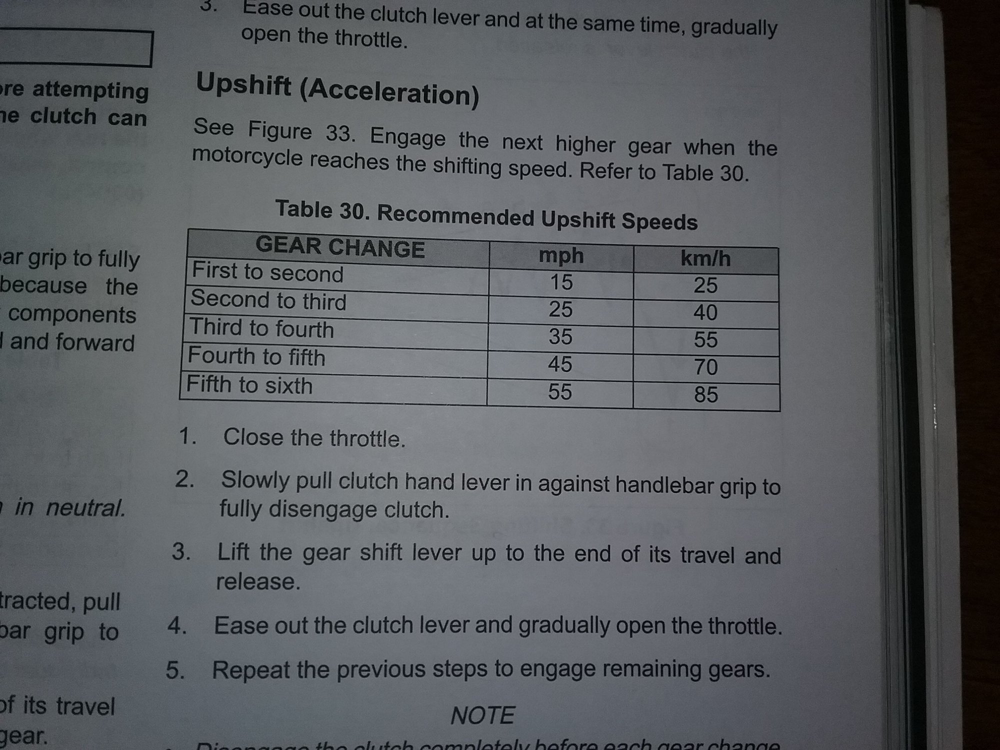

The owners manual for my 07 says to upshift at 15,25,35,45,55mph. I do that on level ground and when I'm not in a hurry and the engine sounds fine to me. I can't say the rpms but I'd guess them at the "it sounds like a Harley" rpm. lol
Good luck
Old Nov 17, 2019 | 06:18 AM
  #40
Steve Sportster's Avatar
Steve Sportster
Joined: Mar 2018
Posts: 2,773
Likes: 2,261
From: Ft. Wayne IN
I concur with dgwv, above. Here's the owner's manual for my 2018 FLHCS (Heritage 114):
I do not shift by what the tach says, but by feel. When I shift normally, it's very close to the recommendations above when I take a glance a the tach.
