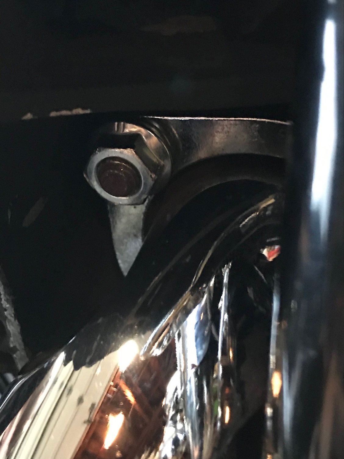

I got the pipe on. Can’t feel any air coming out of the heads so I don’t think I have a leak. But I am smelling a funny mix of burning gas/paper? I saw tiny white smoke coming from where the pipe mounts to the frame, I’m thinking it’s either leftover paper/plastic I wrapped the pipes in for storage, or NeverDull I cleaned the chrome with before I started the bike. Bike hasn’t started in 3 weeks before this
https://i.imgur.com/BqEabfnr.jpg
this is my rear head. If you look closely, you can still see the exhaust gasket. Is that normal? All bolts are torqued to spec

It looks ok to me. Put some dish liquid in some water and squirt some around the flanges at the heads. Put a Shop Vac hose in the exhaust, connect to the vac to blow, and turn it on. If you see bubbles at the flanges, you have a leak. Otherwise you're good.

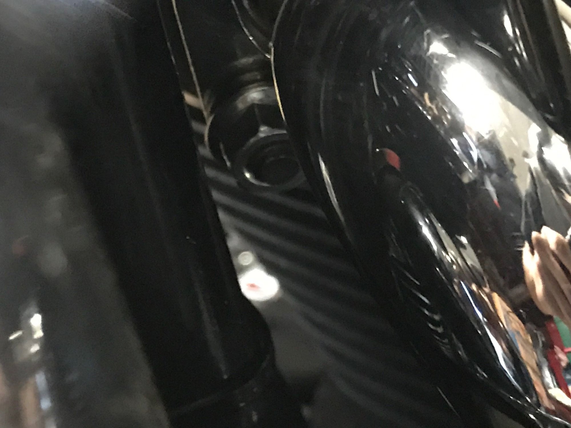

I'm torquing the flange bolts to 110 in/lbs. I take the bike around the neighborhood briefly, and each time the front flange nuts need about a 1/2 to full turn to be torqued to spec again. I want to do the double nut idea, but it doesn't look like I have enough purchase room on the bolts for the nut to grab, as pictured below. Should I torque beyond 110 in-lbs? Manual calls for 100-120 in-lbs. Thoughts?

If it calls for 100-120, you can definitely go 120. It's only going to be a small bit more of a turn of the nut. I'm not sure why these nuts work loose. Or is it that the gaskets are compressing more? A mystery to me.
