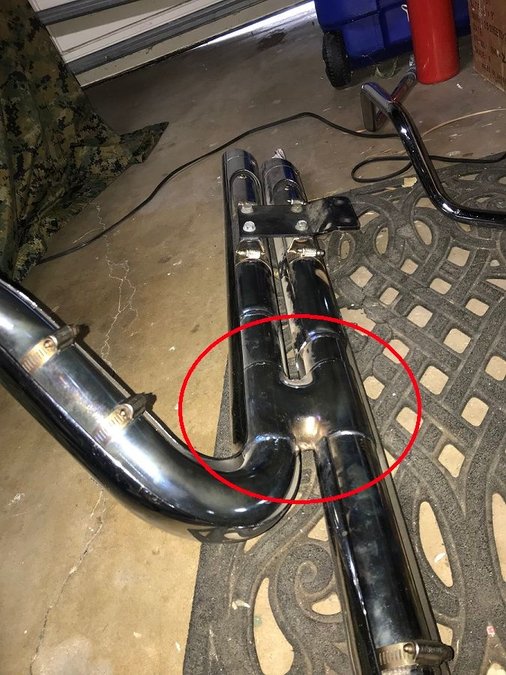

Bike is a '98 Fatboy, EVO motor
I downloaded some installation instructions for various Vance Hines pipes, trying to find mine. All the PDF's were of pipes that are two piece, not single. Mine seems to be welded at one point, shown in the picture. I'm having difficulty trying to get the pipe to fit easily into the heads.

I have V&H Big Shots on my LR, they look like 2 pipes but like yours, are 1 piece. I had to take them off to replace my gaskets, and it is tricky to get off & on. To install, they need to go in evenly. If one pipe is in further to the head than the other, it binds up. Of course, I'm doing all this while balancing the lower pipes against my legs.

I had those on my FX, they're tight but not impossible. Put the first one in place up front, then you're going to have to pull backwards while pushing in on the rear one. It will spread enough to get it in place, then just even em up and tighten em up. It's not terribly difficult, just probably worried about hurting the pipes pulling on them like that. Trust me, you won't. They're tough.
