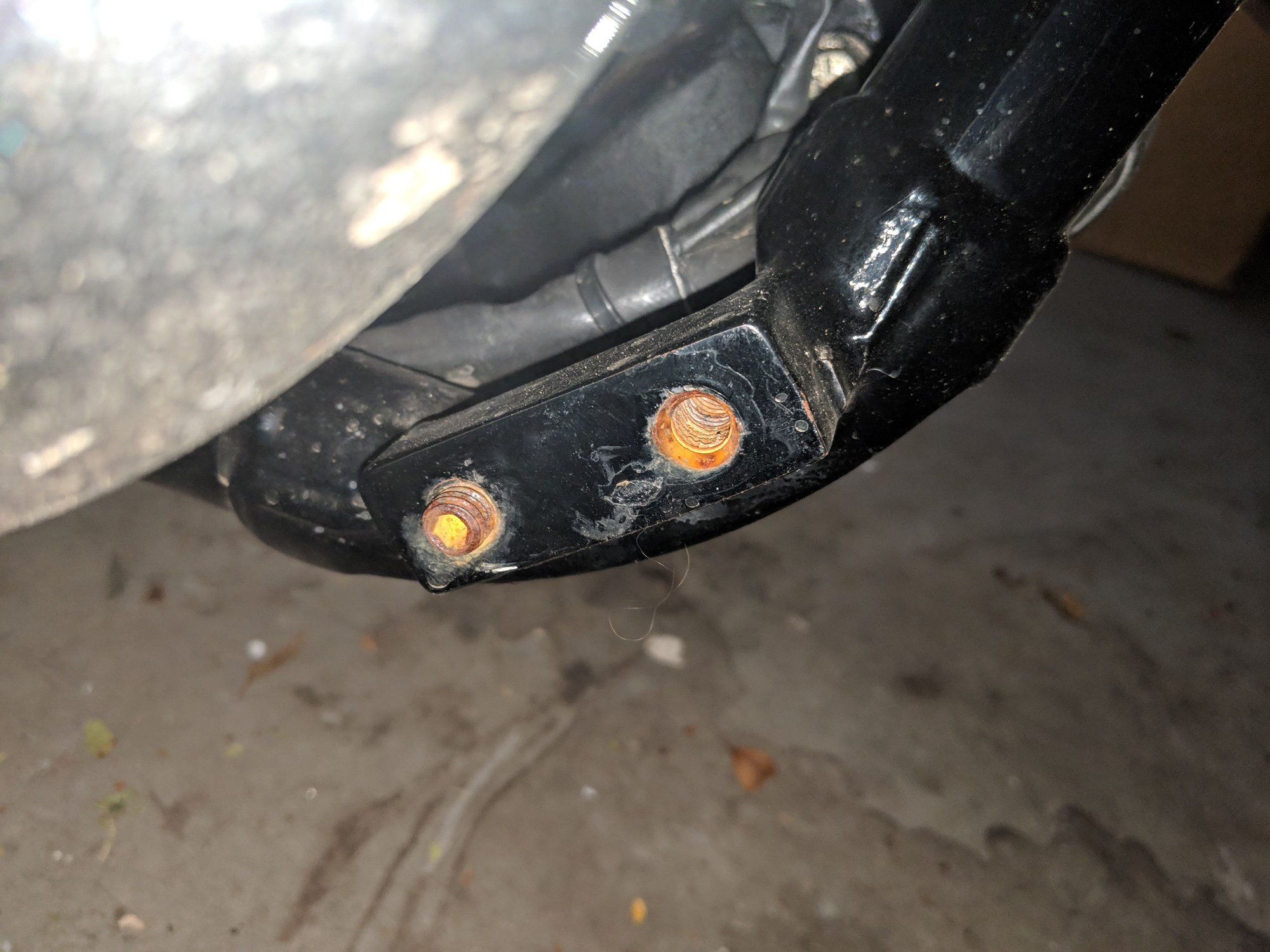

I noticed rust starting to form on my bike where I used to have highway pegs, what to I do to clean this up and prevent it.

Unless you spend a lot you can't get rid of it, only slow down it's progression, WD-40 everything that is rusty or will be.

naval jelly and then use a paint with rust inhibitor. Always make sure that you paint, even if it is with clear paint, any bare metal. This is the reason why many of us do not ride once the streets have been salted.

WD 40 is not a long term solution to rust. GT 85 or ACF 50 are proper rust inhibitors. Even using a household oil or a little engine oil would be far better.
HD do a plastic plug that goes in the bolt holes where mid mounts would be fitted when the bike comes with forward controls.

WD-40 is good but won't last. Will dry up or wash of quickly.
There is a product called "Navel Jelly" , available at any hardware store, that is a rust remover and, from my experience, works fairly well to remove rust on metal that is not deeply rusted. I think it should work on your rust as shown in the pic's.)
After cleaning the rust off, all bare metal needs to be coated in some form. Automotive paint works well where suitable. I use both a spray can if possible, or a small bottle of touch-up paint that has a brush in the bottle.
In threaded areas, like in your pic, it might be best to lightly coat the threads with something like axel grease , or white silicone grease, and then install a bolt to keep air and moisture out. (paint the bolt head to hide it if you want).
The WD-40 trick works well for bolt heads and nuts that are not stainless steel as a preventitive measure, but need to be applied after every wash to be effective. In some situations, like exposed fasteners, a coat of wax accomplishes the same thing if applied regularly.
