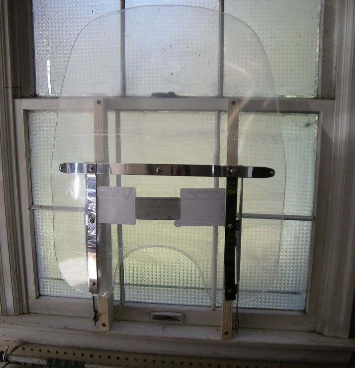

I absolutely love the fact that I can transform my Deluxe from a cruiser to touring trim in just a few minutes. I just wanted to share a little project I completed to allow me to store my windshield when I'm not using it. I made up a couple of stand-offs to mount to the window sash. I bought extra rubber grommets (the same ones that are on you bike) and screwed them to the stand-offs (same spacing as your forks).
Bada-Bing Bada-Boom, a safe place to hang your shield. Yes, the sash can still be raised:=)

Great idea..... thanks for posting

Great idea.

Awesome , copy right that idea !

We have Vinyl windows, but I like the idea.

Is that double pane or triple pane?

Nice Job

That just gave me a great idea. I have Windshields for my Dyna and 2 Sportsters, the quick release models with the clamps on the fork tubes. 39MM fork tubes, 1 1/4" EMT Conduit is 38.5MM outside diameter. Use some stand off hangers to bolt the conduit to the wall in the garage, clamp the windshields to the conduit, if it's a little sloppy put a few wraps of electrical tape around the conduit to build it up.
Sounds like a good project for a rainy weekend.
