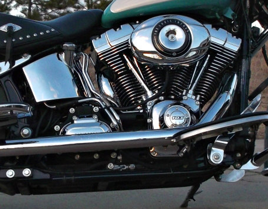

I found this picture that you posted in a thread. I zoomed in and I can see the black external breather hose dropping behind the football cover and then runing rearward. Can you tell me where the hose goes to after that? Where is the end of the hose?
Zoomed...
Also, can you please explain how these "breather bolts" work? Is the oil vented to the air right at the bolt? Does it create a mess?

Go to their web site. Some of the hoses just dead end with nothing. Some of the kits include filter.
Some of the breather bolts have holes in them, the fumes are sucked into the engine to be burned. Others I have seen have a "grove" cut into the backing plate that let the fumes into the engine.
Hope this helps.

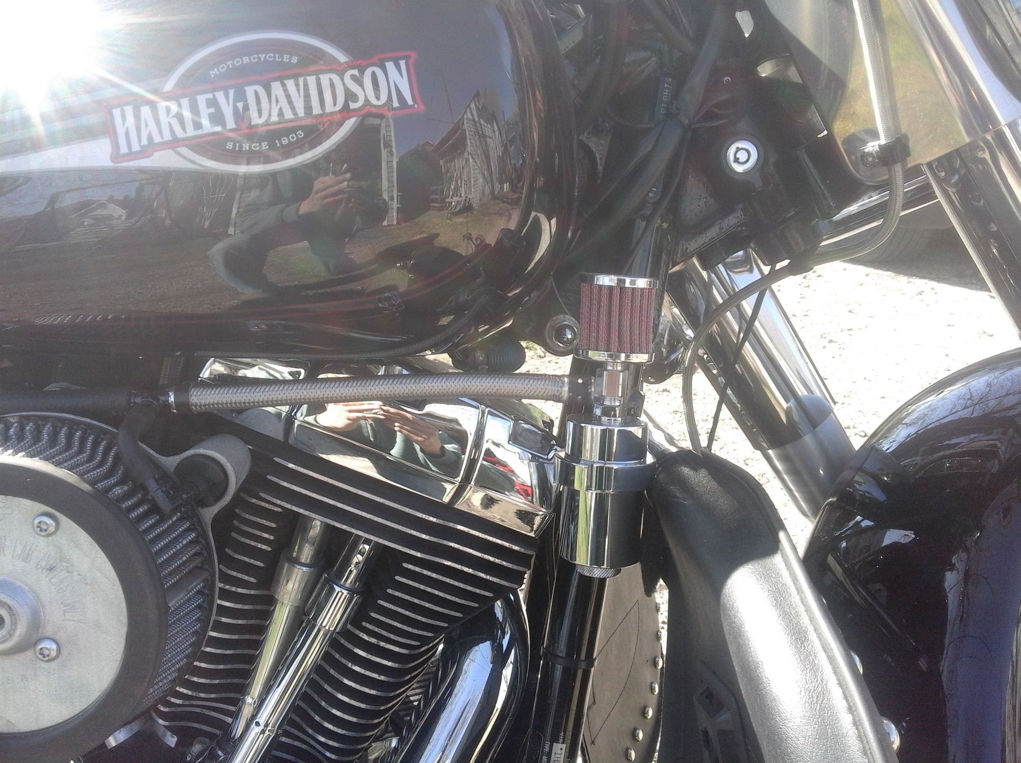

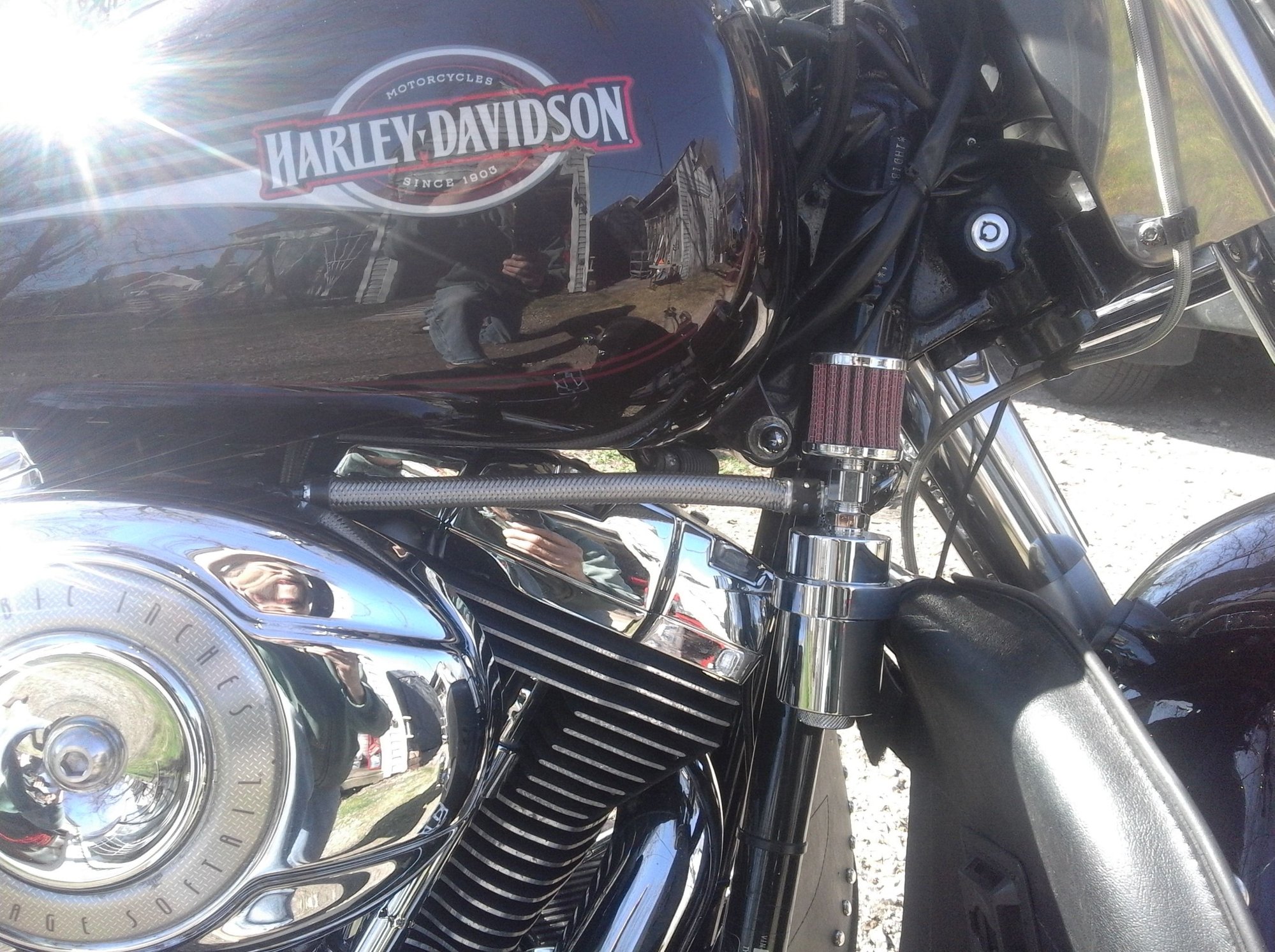

This is mine I bought an extra set of vent tubes, drilled them through so the tubing would fit on the barbed bolt
head. Then ran the tubing to the breather/catch can. Breather is attached to the highway bar with
a plastic coated p-clamp that they use to attach the lowers on the baggers.

Where is the oil going? Into the cannister below the small filter? If so, can you tell us how much oil accumulates in it?
What is that filter for? Is air being sucked into that filter or is oil and air pushed out through that filter?

There is very little oil. Its mostly water. (condensation) I get about a 1/4 of shot glass worth after a day of riding. The filter is actually venting the positive pressure produced by the motor when it is running.
Its not straight oil that is being collected. What travels through the breather holes is a vapor. Moisture and trace amounts of oil. When that vapor condenses, it’s sort of like a watered down chocolate milk. That filter you see allows that vapor to be released into the air. The can helps collect what part of that vapor has time to condense.
If you run a breather tube to the ground, you will not be coating the road behind you in oil like a cartoon. You won’t even notice anything on the bike.
