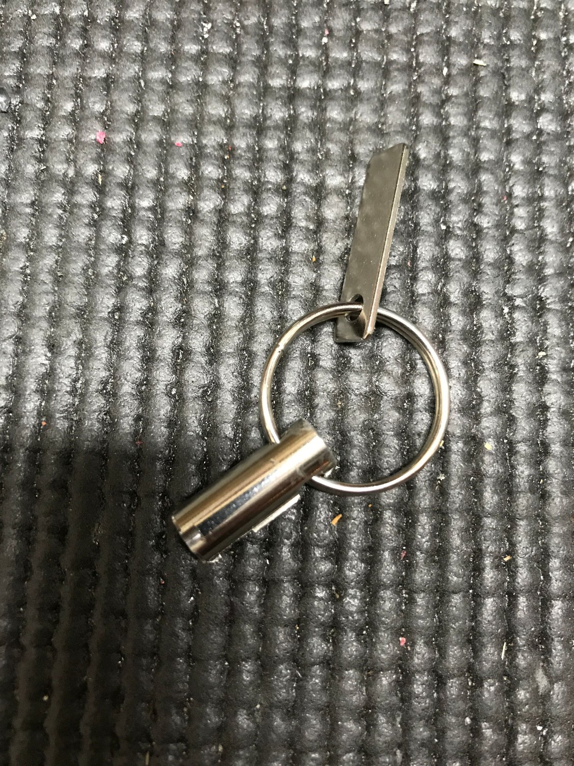

They say in the details for the lock they don’t work with the solo mount, although the sentence is butchered up….
but I use them on my Chopped tour pack on a Solo mount… but I modified the key
basically cut the plastic off the long key, drilled a hole in the key, then put it on the key ring with the FOB… been using it like that for 6 or 7 years I’d guess with no problems.
