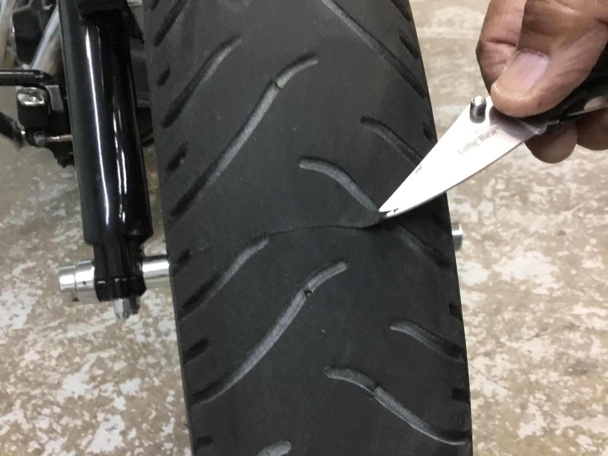

Just happened to park the bike showing this split horizontal across my front tire. 90/90/21 8k miles.. This is the 2nd one I’ve Seen this happen to. If it was from running over something I would chalk it up to that. I would have to have been running backwards for it to slice it like this. Anyone else see this with the E-3’s ? Wish I would have taken of my buddies Custom in Fl last year to send to Dunlop.
I like the tires but can’t trust them again. Don’t know what brand next but it won’t be Dunlop or Metzlers. Check your Lops if you have them.

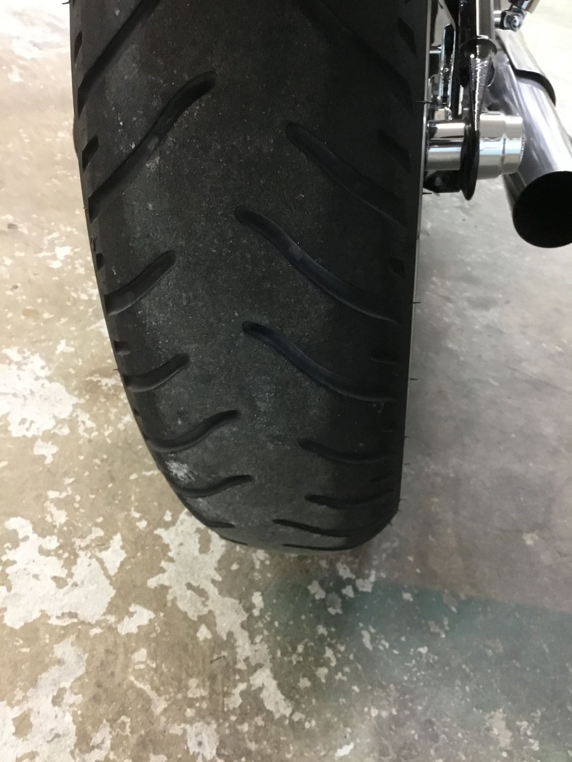

How old is that tire? Do you have a better picture? I can’t see what you’re talking about.

Looks like it's delaminating as well on the left. Hard to tell. Also looks like it's near the end of its useful life, judging from the wear bars.

If that was a front car tire I would say the camber was off.
It looks like the right side of the tire in the picture has much more wear than the left.

Better pic. Rear replaced at the same time and rear gets abused. I agree QC near the end,really past it. I run 40 psi with tubes Ultra. They stay consistent.

Sure looks to me like you ran over something along the way to make the original slice. Bummer.
