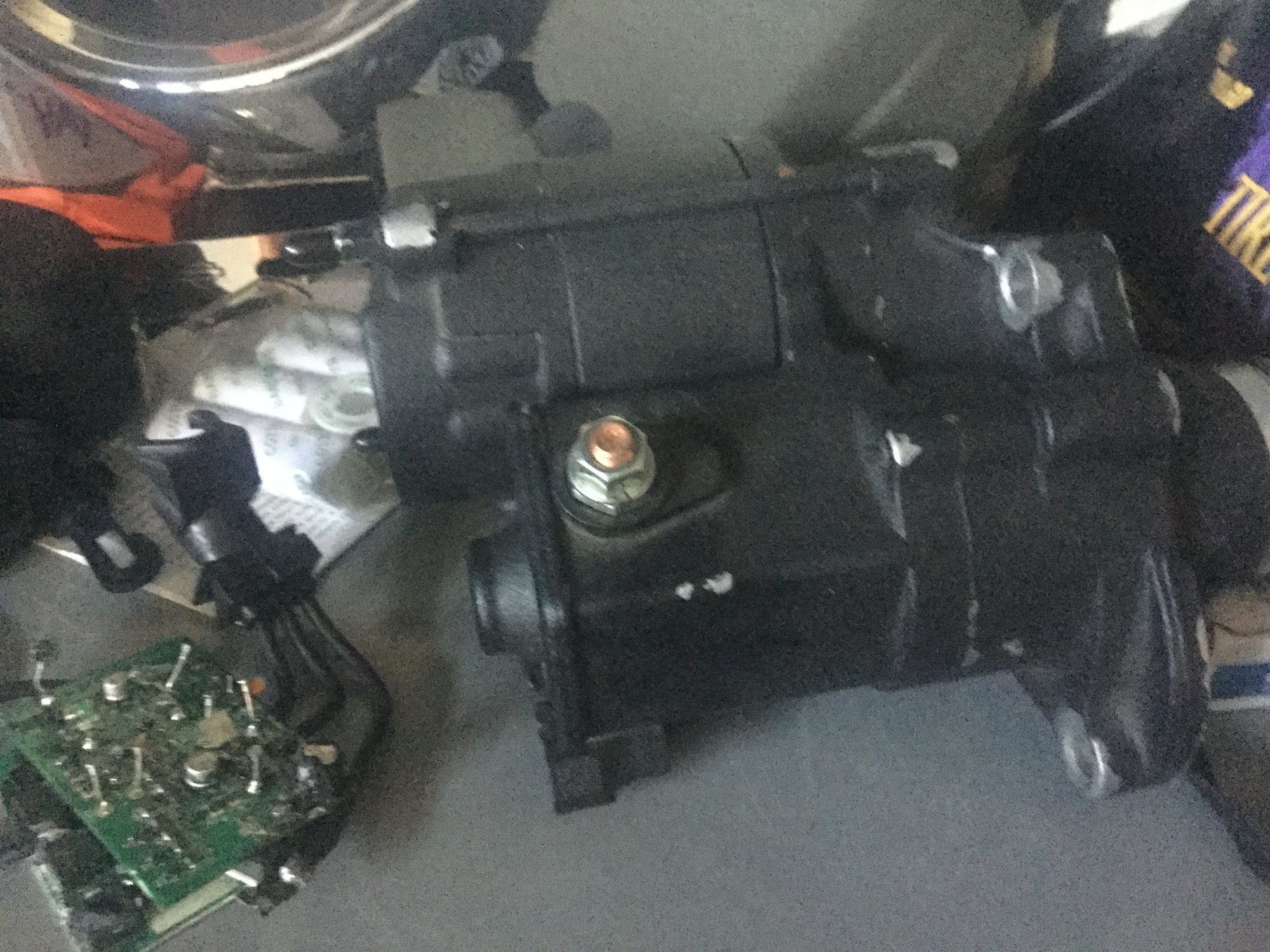

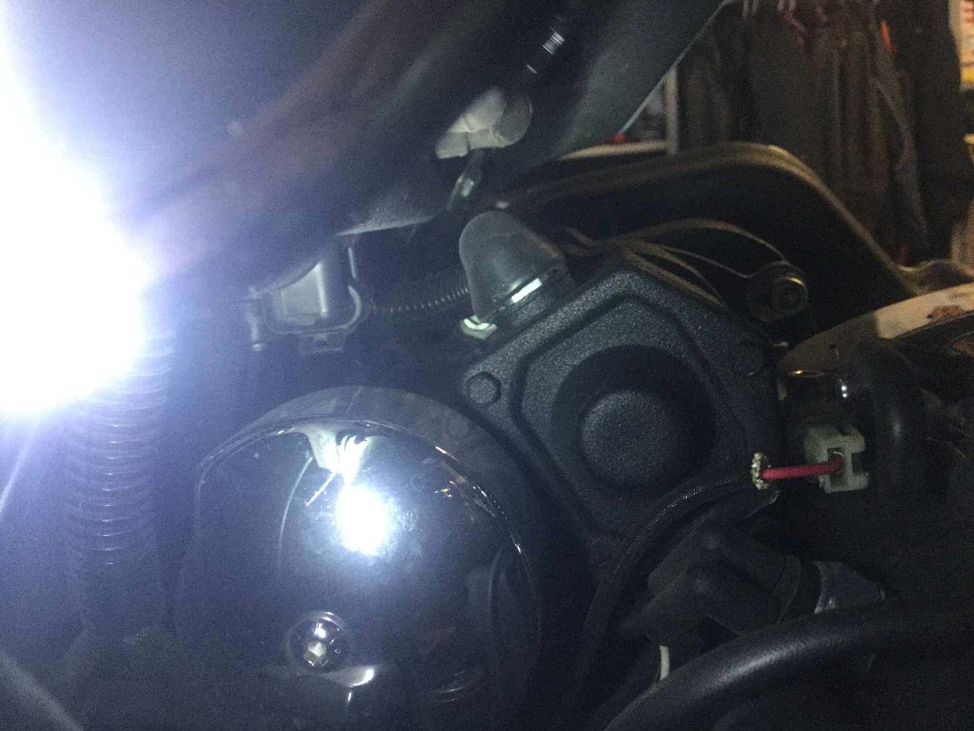

No it isn't. Just take the boot off the positive wire on the starter and hook your positive lead from your jump starter to it. The negative lead can hook to the frame.
Here’s a starter I have off the bike. That nut is the positive lug. You could also hook up a charger here.
On the bike, under the rubber cap.
