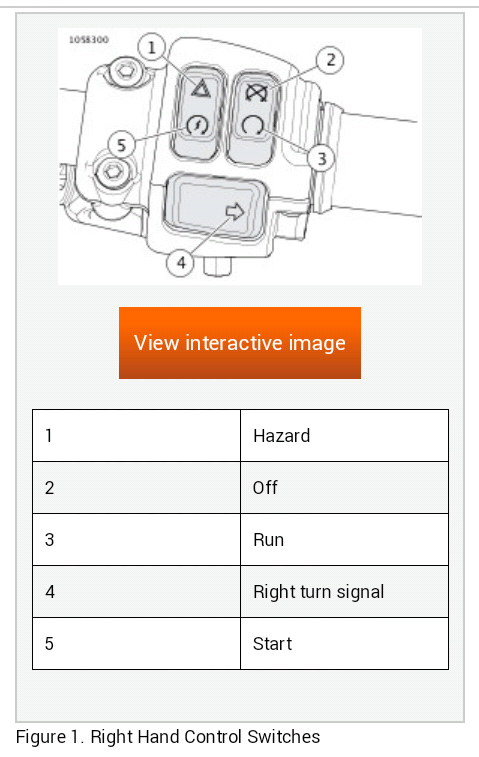

Hi all i went to see a fat bob 2018..it has afob and a key that seems to fit the steering lock...anyone know how to go about starting it up..i cant see that you can press anything ..i took seat off and it does have battery way down ..am i just being thick again..i didnt hit run button cus no ignition lights are on ..any help ?

Flick the kill switch to run and then hit the start button.

Old Apr 15, 2019 | 01:45 PM

Fat Bob is fuel injection, no prime or fuel ****. Turn on the ignition, Right switch to run, wait a few seconds for the fuel pump to engage...hit the start switch.
