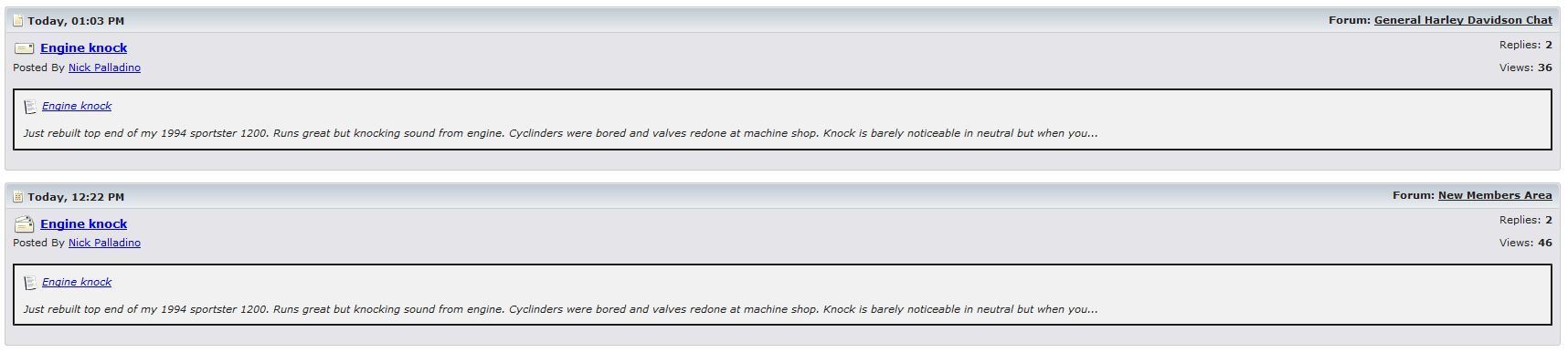

Old May 6, 2019 | 01:49 PM
Mattbastard's Avatar
Mattbastard
Joined: Nov 2009
Posts: 4,315
Likes: 1,663
From: Tampa
