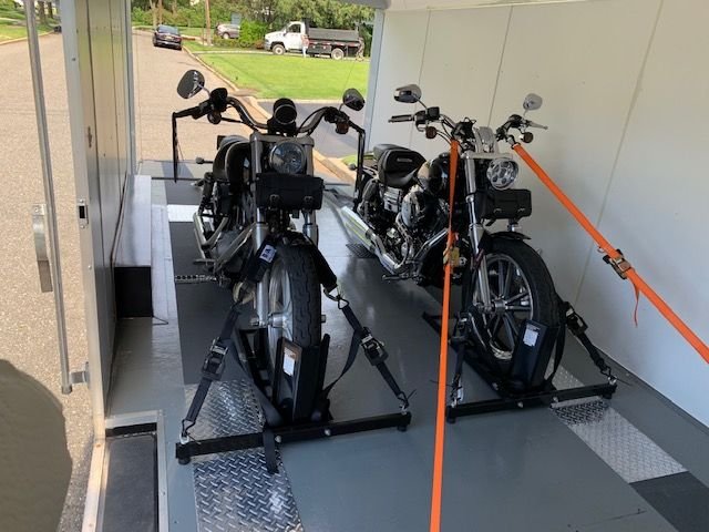

Regardless of what you get...must be dual axle.... most trailer tires are at best unreliable and are only rated for a 5 year life span. A blow out on a single axle could be disastrous. With that said, I have the Goodyear Endurance tires on my trailer and have found them to be the best. Had some made in China tires before them and they started blowing out at 3 years.
I have a 8.5x20 trailer because I use it for my classic car as well.... Plenty of space . I could easily get 4 bikes in.

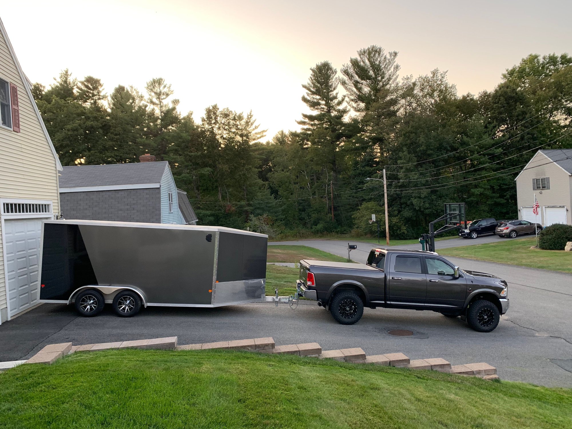

Mine is a 7.5 X 14 + 4 aluminum sloped Vnose snowmobile trailer that I use for both snowmobiles and bikes. It has 2 braked torsion axles and tows like a dream. The vnose gives extra space for cabinets and gear. I also use Condor wheel chocks for the bikes.
