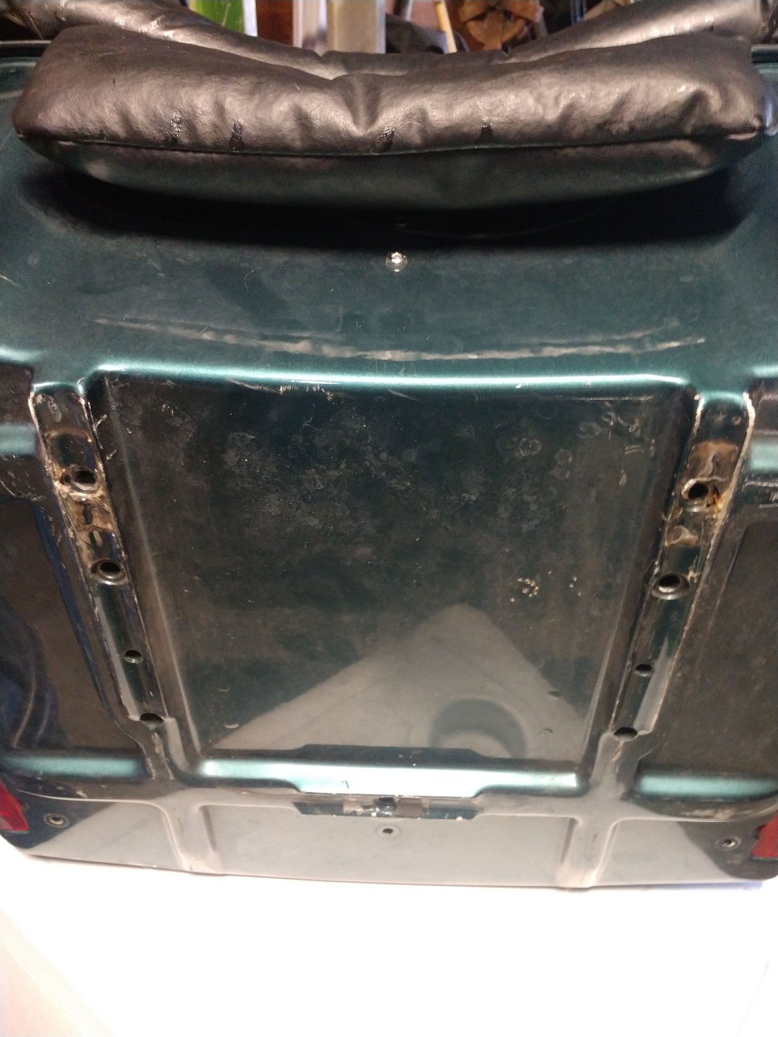

Hi I'm new to this looking for advice , I got a 2000 classic tour pack given to me and I would like to put it on my 2011 street glide , I have bought a two up hogworks two up quick detatch for it but hole do not match , what do I need to do , thanks in advance for your help

Oh, don't ruin the Street Glide. What holes you talking about???

The ones on the tourpack to the bracket

Not able to drill new holes in the tour pack bottom?

I can but not sure if I need to use a filler in between where it used to mount

Can't help you there, based on not knowing how close they are. Some move the pack back by just drilling new holes. I wouldn't think they use filler. My Ultra I believe has 4 - 1/4" bolts.

The new holes would be about 1" in from the old holes

Then I see no problem unless the existing are cracked. You'll know when mounted if its sound.

You may be better off making an adapter plate/bracket that will bolt to tour pack on the top) and to your detachable rack (on the bottom).
Flat aluminum would be my recommedation as it is light abd strong enough to secure the tour pack and it's cargo.
