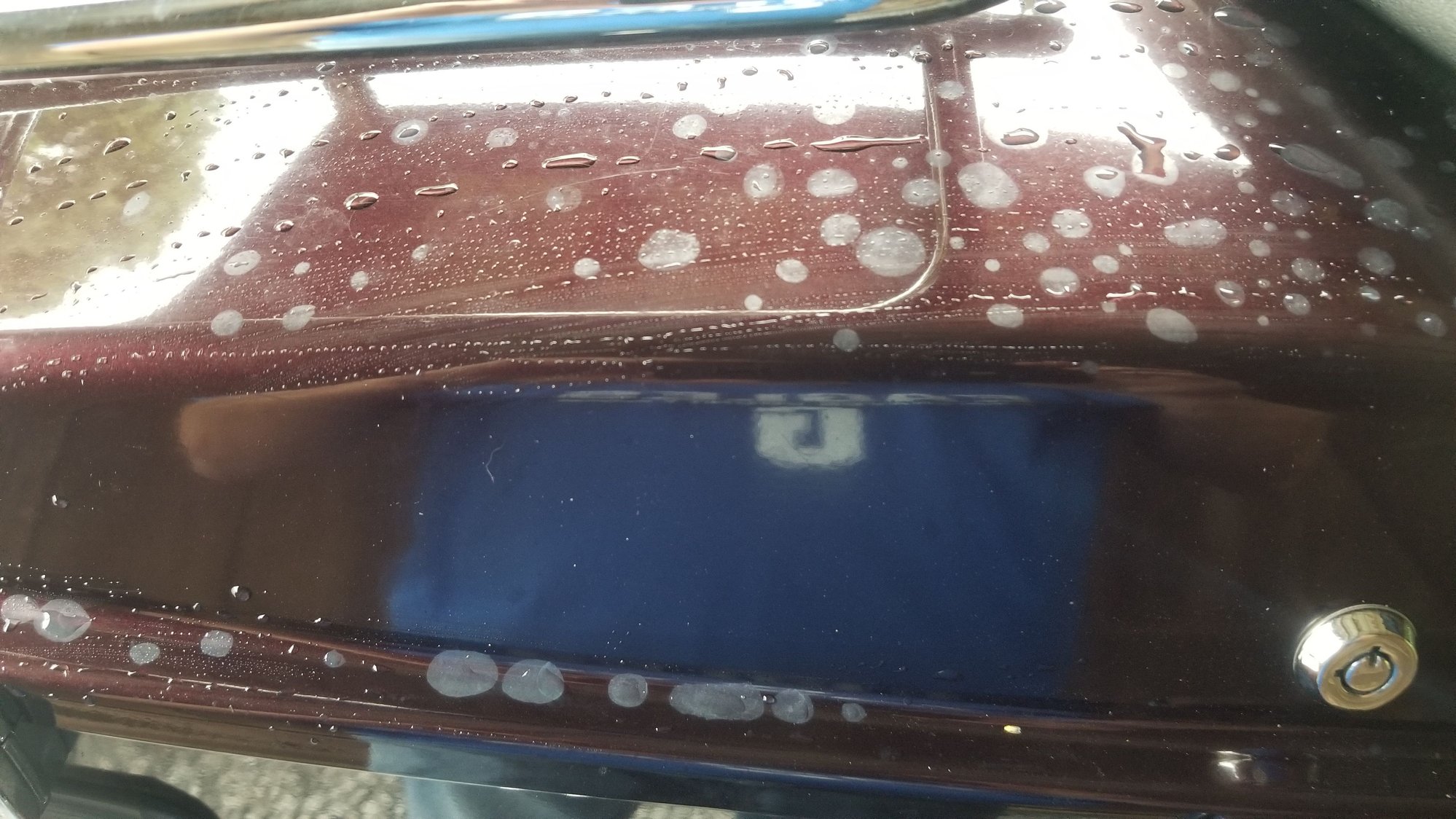

I recently purchased a 2006 HD electra glide ultra classic. It has a weird issue with the paint. When it is wet I see these ghost images of spots. When it's dry they virtually disappear. Has any body seen this kind of thing or have a clue what it might be?
Ghost spots when the paint is damp.

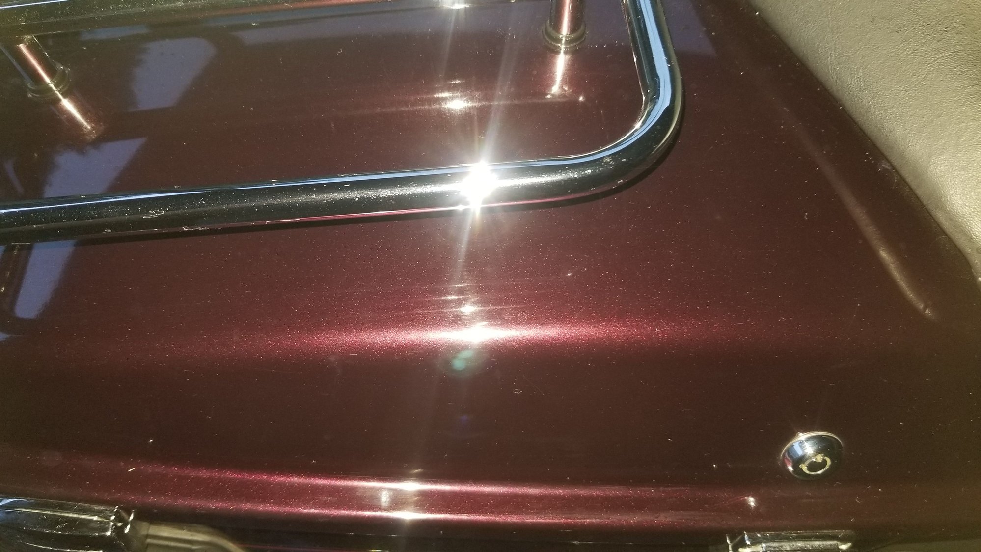

Dried and buffed off with a microfiber towel.

Mineral deposit in your water......

Possibly from wax.

I think the clear coat is failing .
And what you are seeing Is the moisture under the clearcoat after you wash it. If you continue to wash the bike in the sun . evaporation of the water getting caught under the clearcoat will continue to make those grow larger and larger .
You will know if this is the problem soon because one of those will pop open and the clearcoat will start pealing off .

That's pretty weird but I think Ironhorse nailed it. It makes sense.

I think you're right. I assume I have to sand the clear coat off down to the color and then clear coat it again in order to fix it?

Cheaper route would be to try & clay bar it...might fix it all up w/o $pendy sand/paint/coat.

If you've got time to spend on it, try the clay bar, if that doesn't do it, treat it like how you would address a clear coat scratch: Try a proper polish (not a wax), if still there, a rubbing compound. So you're slowly increasing the abrasion, just to see if that saves a re-coat. You can even take it to a fine grade of wet 1500 or 2000 paper. The shine comes back with a polish and waxing. Pick a small patch in a less visible area, to experiment.

Try the clay bar
if it didnt remove it
Try clear coat compound

I've done more than a few paint jobs ... You will NEVER get the clear coat off without damaging the color coat
