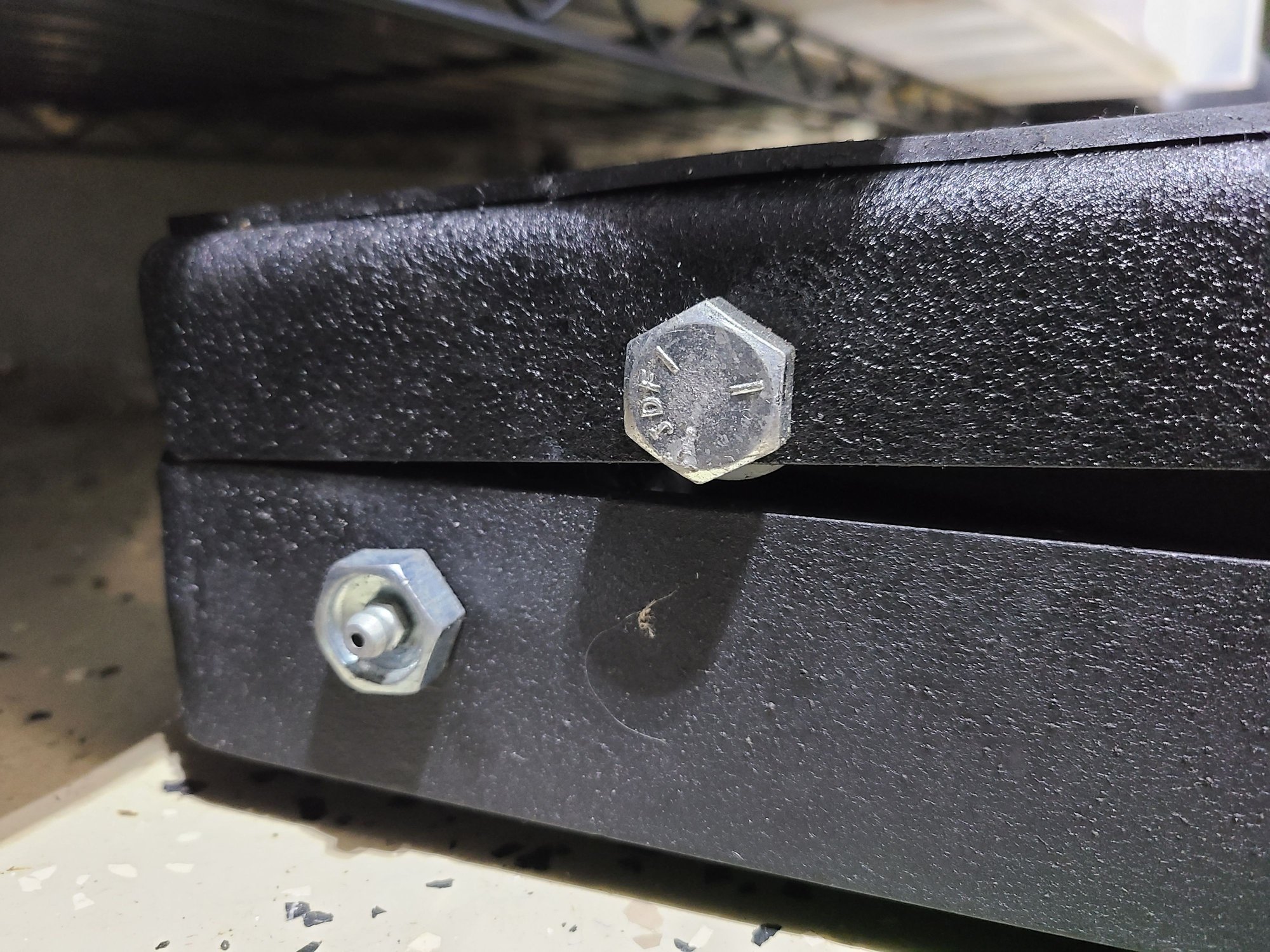

here's a picture of mine fully collapsed and you could see the lift arm in the front is touching the frame. He has about a 3/4 inch Gap there
maybe it's not assembled right. put a picture of his jack

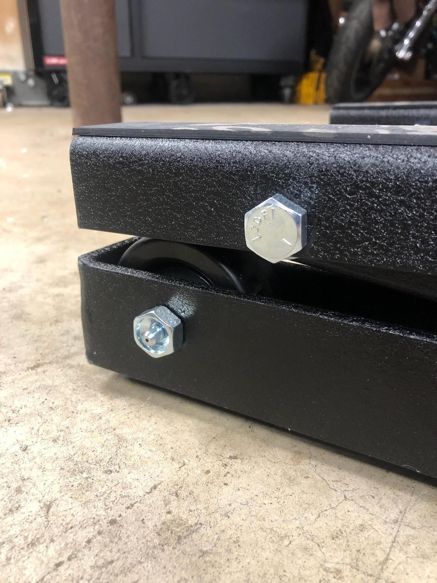

This is his
it's assembled correctly. All you have to do is put in the two screws to mount the jack to the lift. The adjustable height screw shaft is screwed all the way down as far as it could go and inserted it into the slot in the arm. He opened up the valve and stood on the jack and it will not go down any further

Is there the same amount of difference between the two bike frames? His frame is higher than yours?
Edit: never mind. Looked at the pics again and noticed the difference. The front of his jack isn't coming down as far based on the gaps between the front of the lift arm and the wheel on the jack.
I just got off the video phone with him and everything is correct. The adjustable height lift arm is fitting into the socket where it should on the frame. He even bypassed the jack and there was no change. He can't even find what is stopping the arms from collapsing. All nuts and bolts are clearing and all crossbars are clearing the frame but it will not collapse completely. He's a very knowledgeable guy who does a lot of work on his own bikes and cars so I don't think this is user error.... I'm going to try to stop at his house over the weekend to see what I could find. He paid a lot of money for this Jack and is a little disappointed at this point. Hopefully he could get through to J&S on Monday
