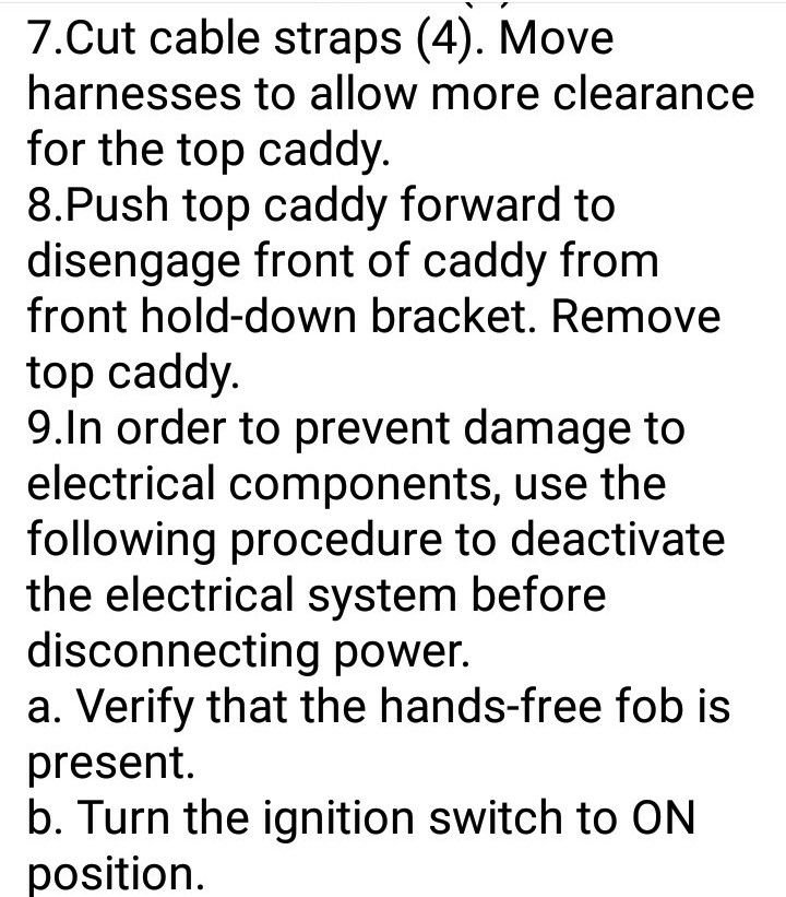

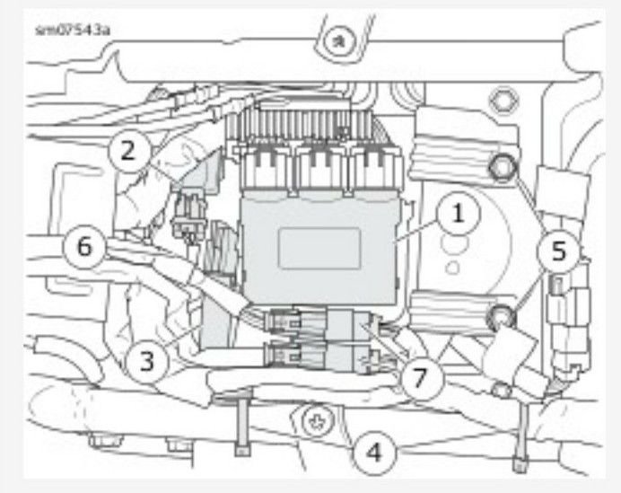

Did you cut the 2 cable straps (#4)?

From: northern illinois
no i didnt cut the cable straps should i ?
Yes, make sure you know which ones---it helps to move the large array of cables and wires out of the way to remove the cover when you cut them--you know the other cables connected to the cover slide of the clip right?They push towards back of bike

From: Plover, WI
Yes, see step #7.

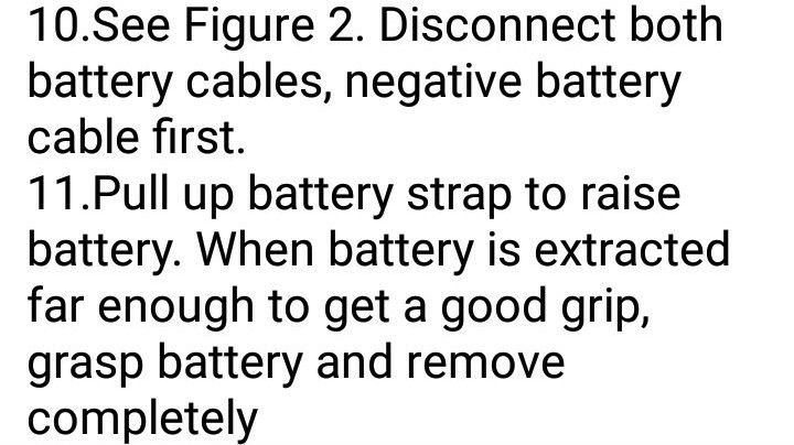

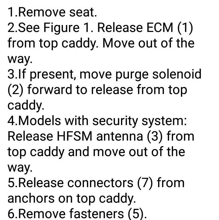

Old Mar 13, 2021 | 10:12 AM
mazz's Avatar
mazz
Joined: Aug 2007
Posts: 943
Likes: 200
that is great i looked at manual and didnt find these steps
thank you very much
