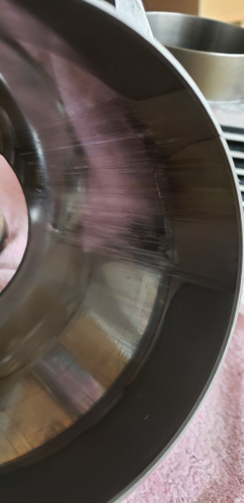

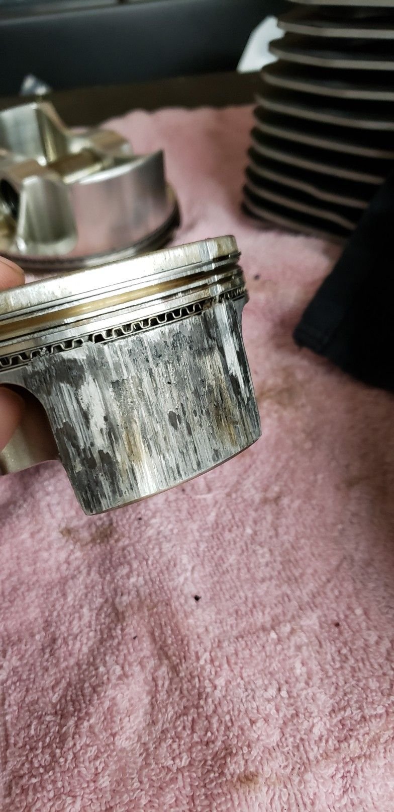

Edited .. I forgot to mention a chunk of the rocker standoff being sheared off. The chunk found in the oil pan. Destroyed one of my heads.
The pics are from the second failure.

When trying to compare the S&S 131 with a longer stroke and shorter rods you have to remember the longer Stoke, shorter rod puts more side load into the pistons and cylinder walls. The S&S cylinders do not use Steel liners and the HD ones do, so you are trading small differences that I do not believe amount to a hill of $hit when you boil it all down for a street engine. So if your looking for one being better than the other it's just BS in this case as the steel liner is much stronger than the non steel liner but slightly thick S&S cylinder.
That said it all about the proper measurements and assembly of the build and who is doing it, than the differences in the parts themselves. The pictures you posted above were of a build done with S&S cylinders and you can see it did not last long at all. As I recall less than 200 miles before the problems occurred. Would I blame the cylinders for that failure NO but they were junk afterwards non the less.

Does Zippers use S&S cylinders ??
I dont know for sure. The pics are the cylinders of the Zippers 124 kit. Im not sure where the 200 mile comment is coming from. Failures occurred at under 20k both times.

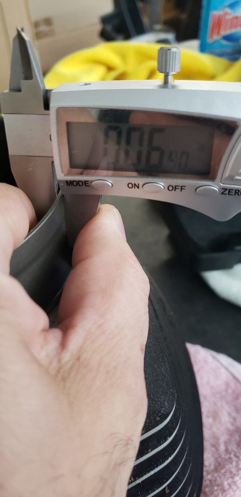

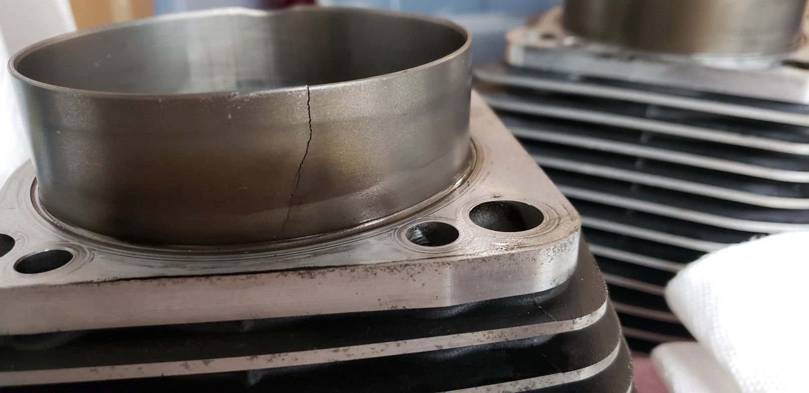

This is the cracked spigot .. think Im measuring correctly .. Certainly dont claim to be a mechanic or machinist.

Use the pointed end of the caliper (if they're in good enough shape) to measure that, the flat across the points is less wide and you'll be closer to the right reading.
Ok thanks .. Ill do that ..
