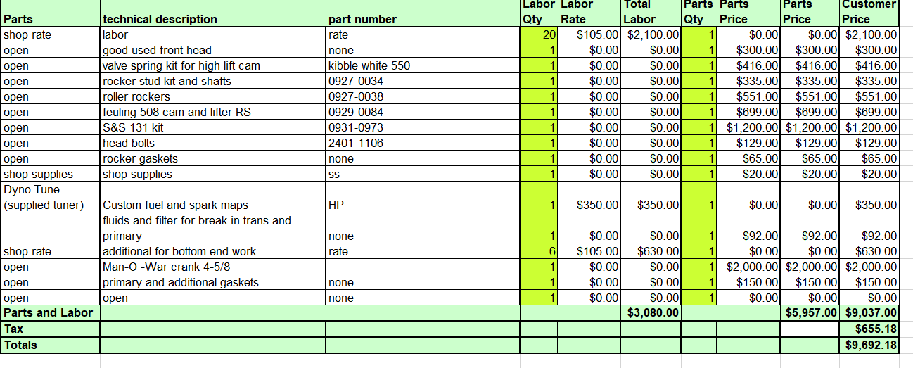

I occasionally hit it off the line when I'm trying to impress/show off , but mainly I'm a roll on kind of guy .. like to feel the torque and pull as I run through the gears. There alot of history with this bike which is/are dictating where I go next. Ive attached one quote I got for aftermarket. I also got a quote from a Harley dealership for a HD crate 131 install. The engine is 6200 bucks, install labor isnt to bad .. but once they added stuff to fix the issues with that engine, it came close to this estimate. If your all interested, I can go into the details of this bike and how I arrived at .. well .. what I'm looking at now.
