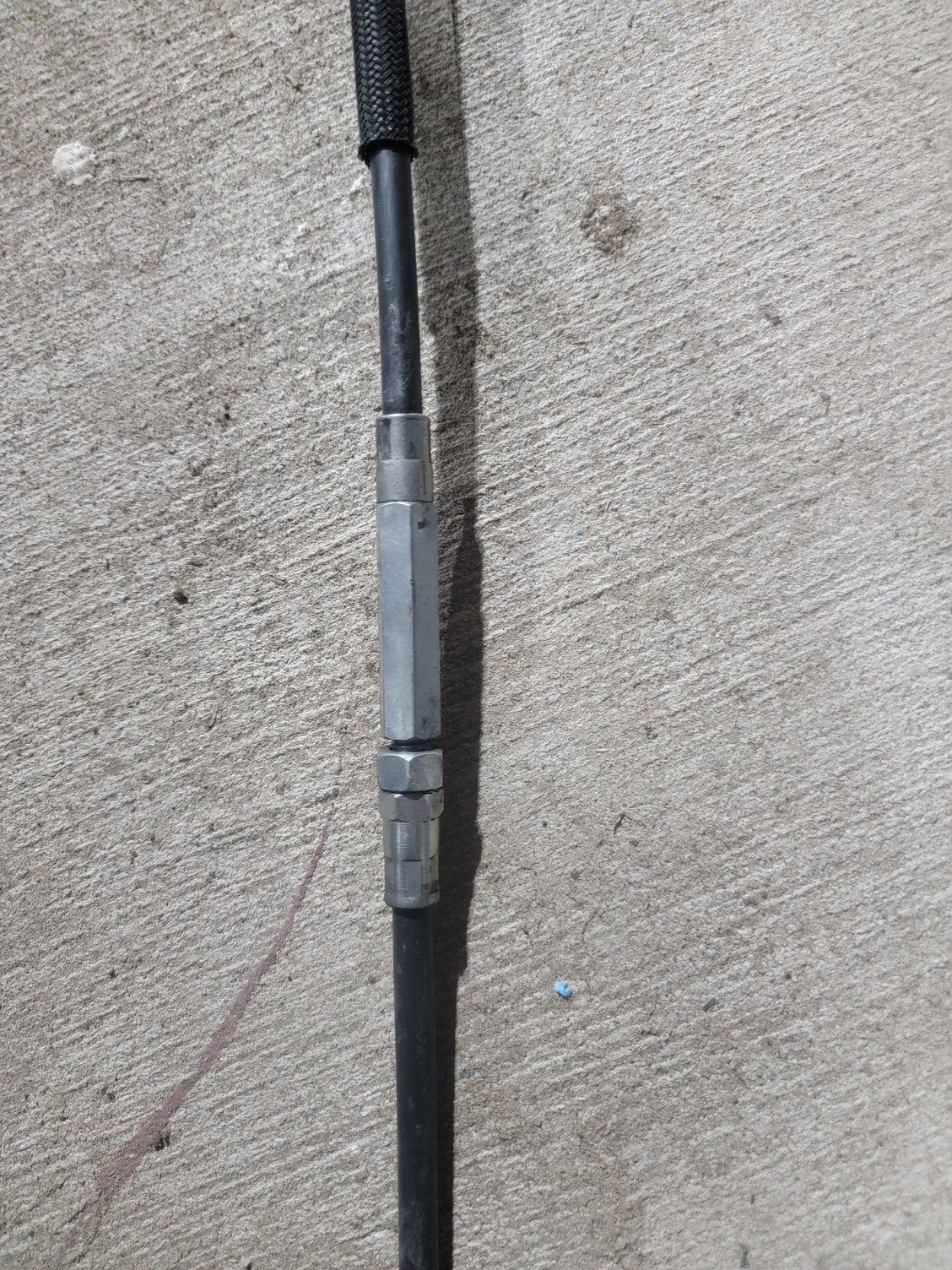

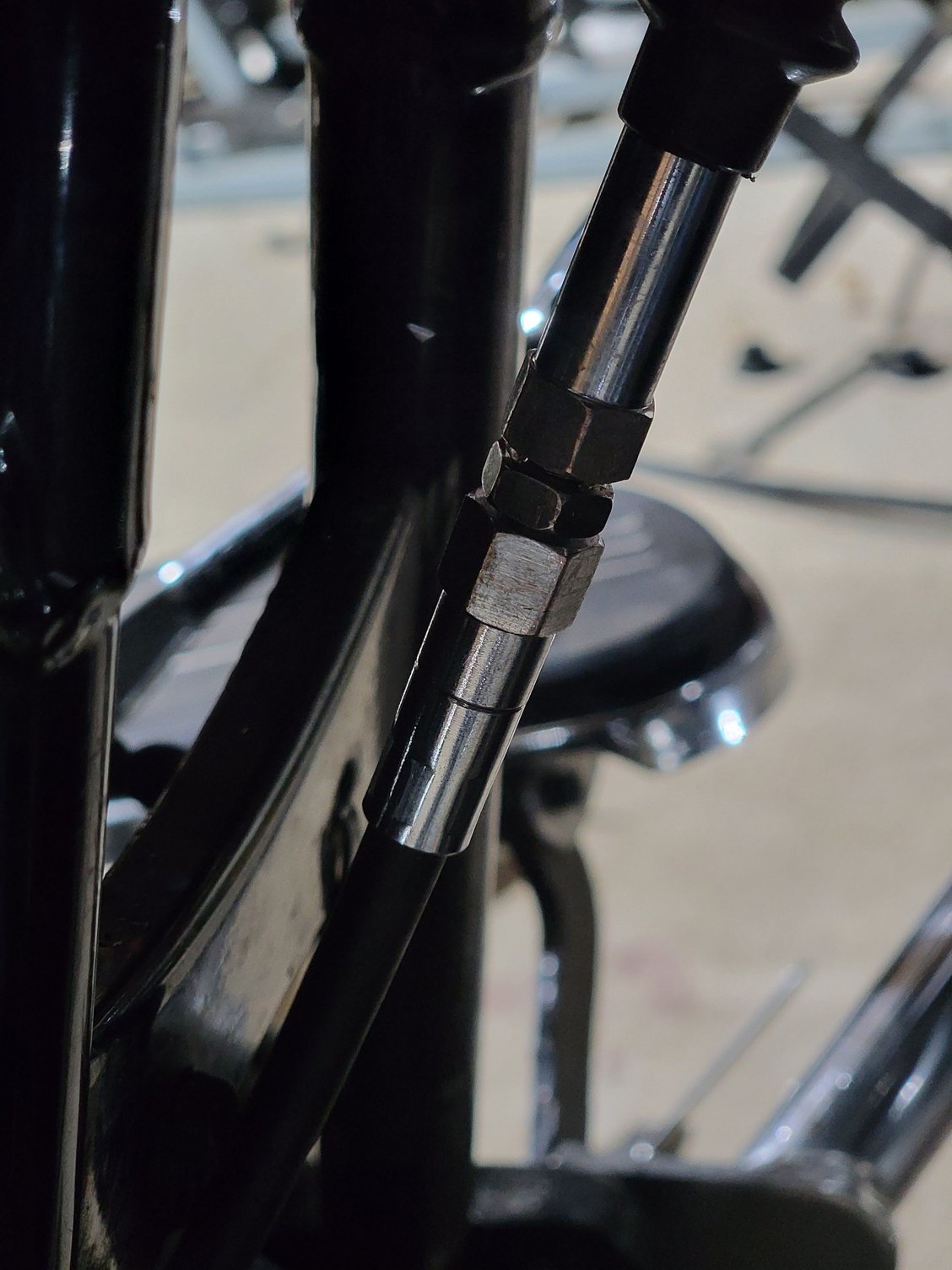

Putting new bars on.my 08 FLHTC. Ordered cables from Hill Country Cycles. Has anyone been sent a cable without it having a adjusting nut on it?1st pick is OE clutch cable.2nd is aftermarket cable, no adjustment nut, everything is attached to the cable.
​​​​​​​thanks for your help.

It’s the same as your OE cable.Don’t see any difference.They spread by spinning apart from one another to take up the slack.The center nut locks it in place.

Much nicer finish on the new cable. Otherwise it looks to work the same. It's adjusted to the shortest length.

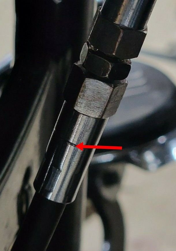

The new cable does not have an adjustment nut like the old one. Neither end is free spinning. It will not adjust without rotating the entire cable.

I assume you tried to loosen up the lock nut. Maybe it's defective, so contact the vendor and get it replace.

You'll need 2 wrenches, only the bottom 1 spins at the split.
That's what the 2 "Flats" are for.
Then the jam nut goes against the bottom adjuster.
It could just be tight.

Spray some lube in this joint to free it up.
Go to 12:40 in this video.
