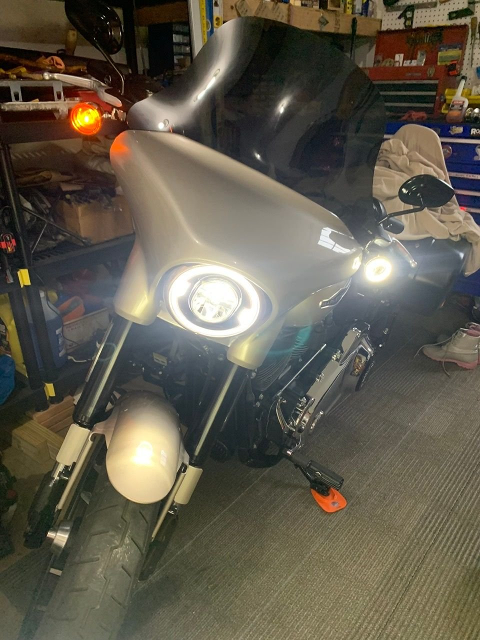

Another vote for HD. I put them on my 2018 Sport Glide and am satisfied. They are plug and play, nothing else to buy.
Here is a comparison photo.
