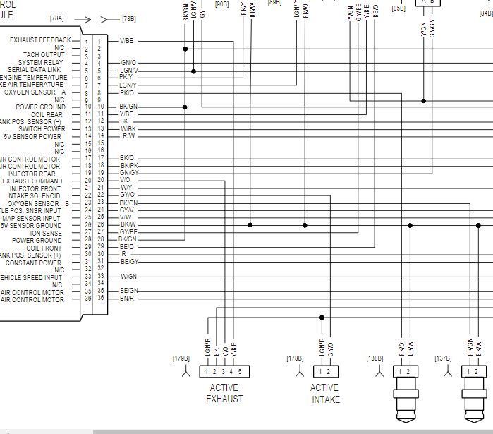

Guys- it's an 07 softail- you cannot hook the O2 sensors up wrong...

They are both the same color. Both black. Thank you!
The wiring diagram for 2007 Softail shows front and rear O2 sensors as different color wires on socket (1). And going to different
places on the ECU.

I looked at the wires. All are the same color. When I looked at new sensors they had the same part number front and rear. I'll ride it and keep watch on it. Nothing more I an do. Like I said. I ran her the other night and had no problems or check engine light. If I do end up having a problem I will post it here!

The ECM monitors the exhaust O2 from front and rear cylinders independently. In closed loop mode it adjusts the fuel in each cylinder separately based on the voltage sent by the O2 sensor for that cylinder to maintain the proper AFR of 14.6. If the sensor leads are switched the AFR's will likely be adjusted to the minimum in one cylinder (rich) and to the maximum in the other (lean).
