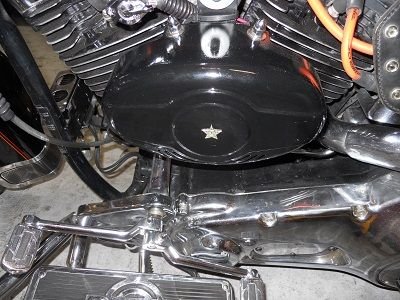

Well the stock horn on my 07 bagger was sounding pretty anaemic for a while. Today I had to use it on the highway at 70 mph, I thought WTF was that. Could barely hear it.
When I got home I did a little surfing on the net and it seemed like the Fiamm freeway blaster 72112 low tone had pretty good reviews. So I went down to my local auto parts store and I grabbed one for under $20, I thought, what the heck I'll give it a shot, can't be any worse.
I downloaded a DB app for my phone, this one was from NIOSH. The freeway blaster was advertised as 130 DB. I measured my stock horn it was 99 db, I was actually surprised that it measured that high. I then installed the freeway blaster and measured again. The freeway blaster was 115 db, it fell short of the advertised 130 db but it was noticeably louder, different tone and I'm quite satisfied. It was a 5 minute job, and it does fit in the cowbell. Just thought I would share
Oh, apparently the stock horns on the newer Harleys are louder than the older models. Not sure but I thought there was a change around 2012? So before you run out and swap your stock horn for one of these Fiamm's you might want to check which one you have because there might not be much of a difference if you have one of the newer ones
