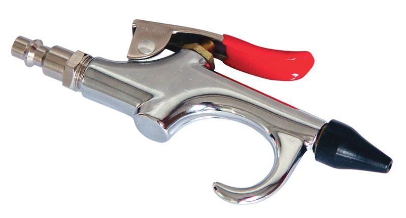

Received them and installed last night, had to go slow, they clog up really easy, used my hair clippers to vibrate them in, I’ll take it for a ride today, and see if I notice a difference
You're not much of a mechanic are you?
I use a blow gun to put beads in. Takes less than a minute. Small shot of air is your friend. Do you have an air compressor?
Use your hair clipper/vibrator for something else. Use this on your beads.....
