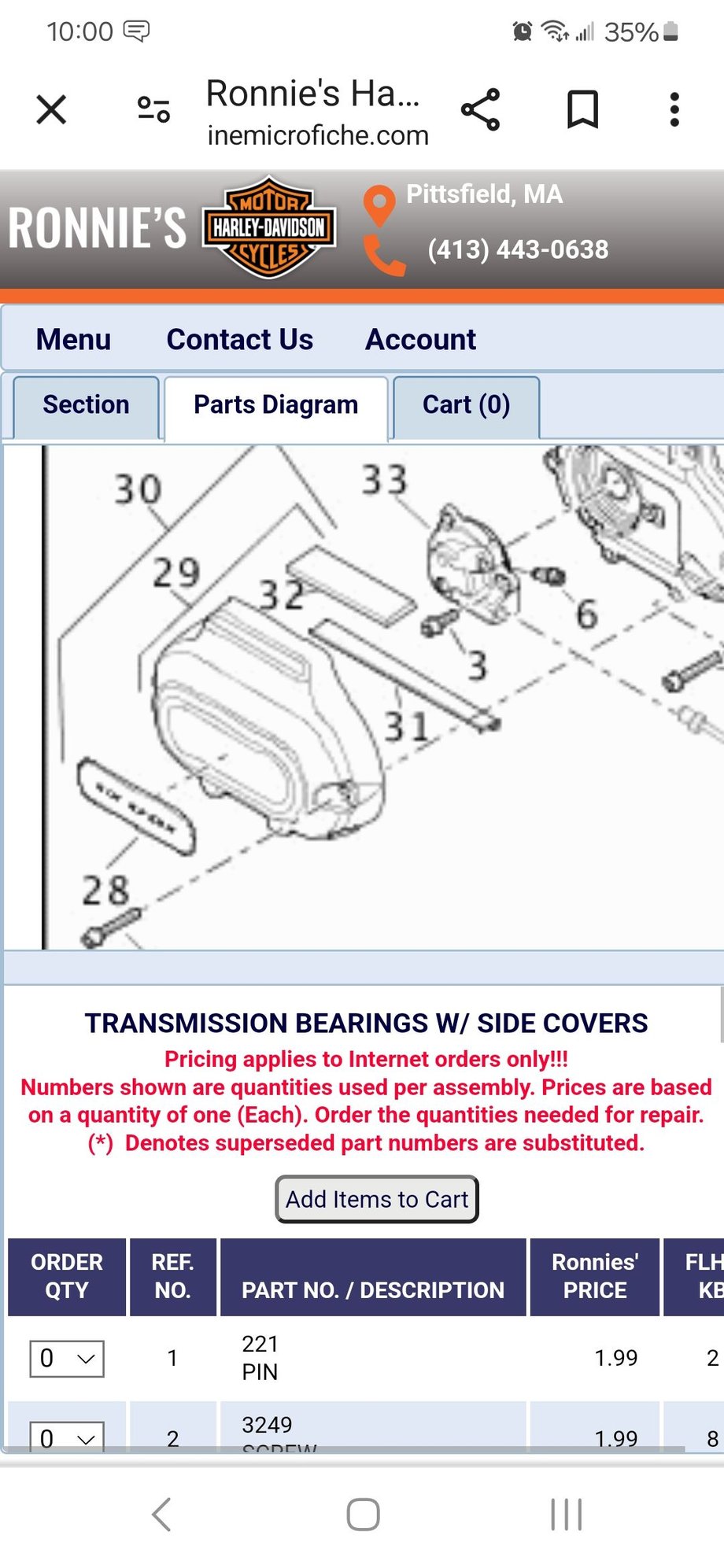

I found a little trick to get the tranny cover off without loosening the pipes. This is on my 19 Street Glide with dbx 4.5 pipes. I am able to get all the screws out of the cover but there is a rubber gasket that is on the bottom of the cover. If I pry that off I can wiggle the cover enough to get it to clear the pipe and come off without loosening the pipe. To put it back on I add some double stick tape to the rubber piece and squeeze it back in when the cover is slide back in place. That rubber piece just makes it so it doesn't clear when trying to lift out the cover. Without that rubber piece it gives me enough wiggle room to slide the cover up and out. I may have had to loosen the heat shield but I I'm not sure.
#31
25800109TRIM, RUBBER
