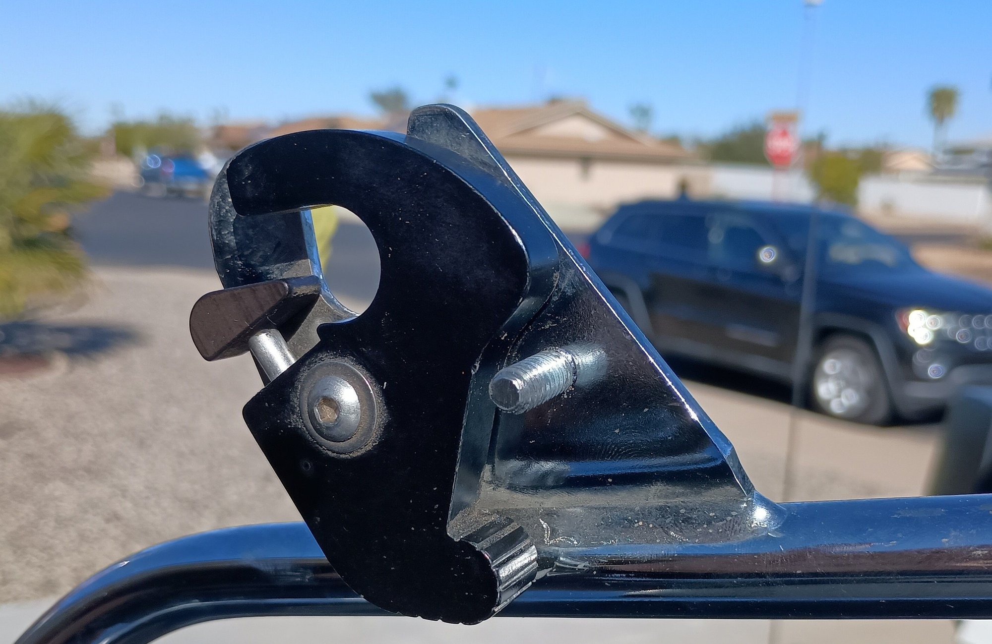

To secure my quick detach trunk on my road king classic I drilled a hole and tapped it for a 1/4 20 bolt.
Once the trunk is installed. Put in the bolt. This will prevent the latch from swinging open.
[img alt="I put a dab of blue loctite on the bolt before I installed it.
Of course this isnt going to stop a thief whos determined to get it, but it will stop the grab and go type."]https://cimg8.ibsrv.net/gimg/www.hdforums.com-vbulletin/2000x1504/img_20250309_094647260_hdr_89a79f8fb721e2295d6b4c8 060a943f7e93b0202.jpg[/img]
I put a dab of blue loctite on the bolt before I installed it. Of course this isn't going to stop a thief who's determined to get it, but it will stop the grab and go type.
