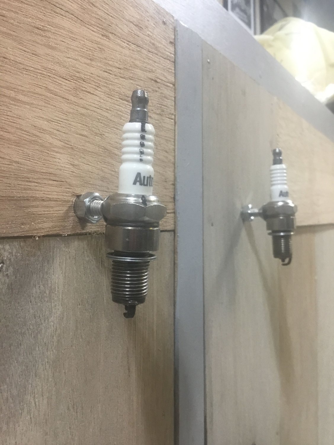

Once a bike is tuned and I’m happy with either a light cloudy grey or the coffee tan, I clean them with a wire brush, a bit of sandpaper and re-gap and re-index once, maybe twice before replacing. About every 3-4 months. Usually if I decide to clean and run them again, it’s because they look like they don’t even need cleaned.
Once re-installed once possibly twice, I toss them. I did have like about 6 or so sitting in a little pile.. I made handles out of them with a dab of jb weld and a bolt lol.
Gonna do these handles and four more cabinet doors on the other wall.

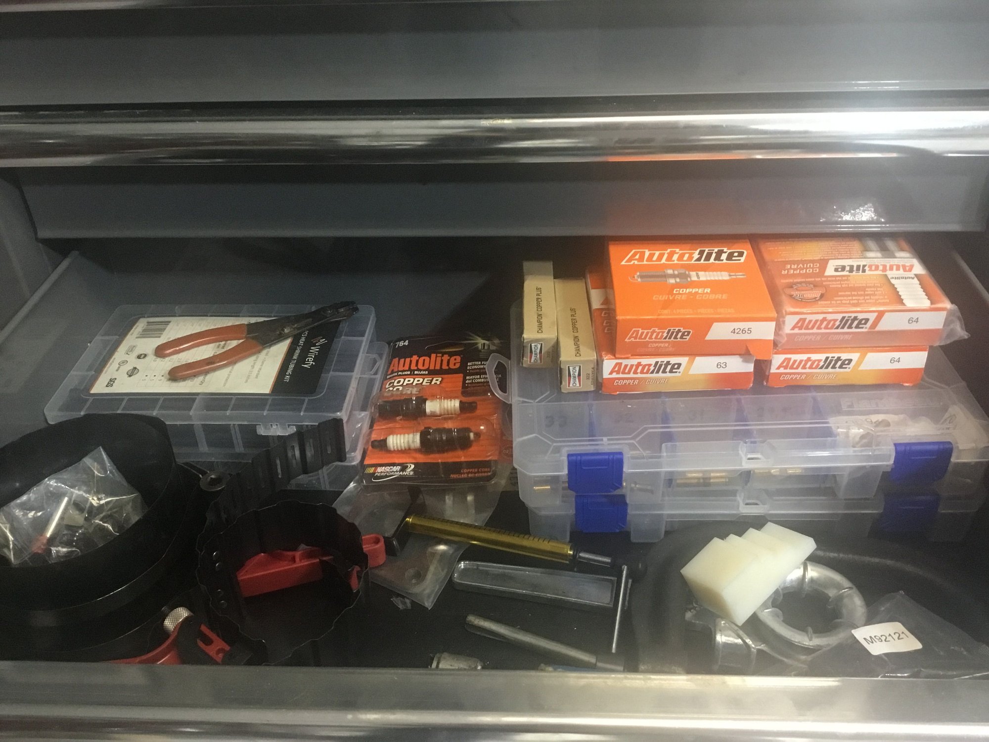

I keep various heat ranges on hand as well.
