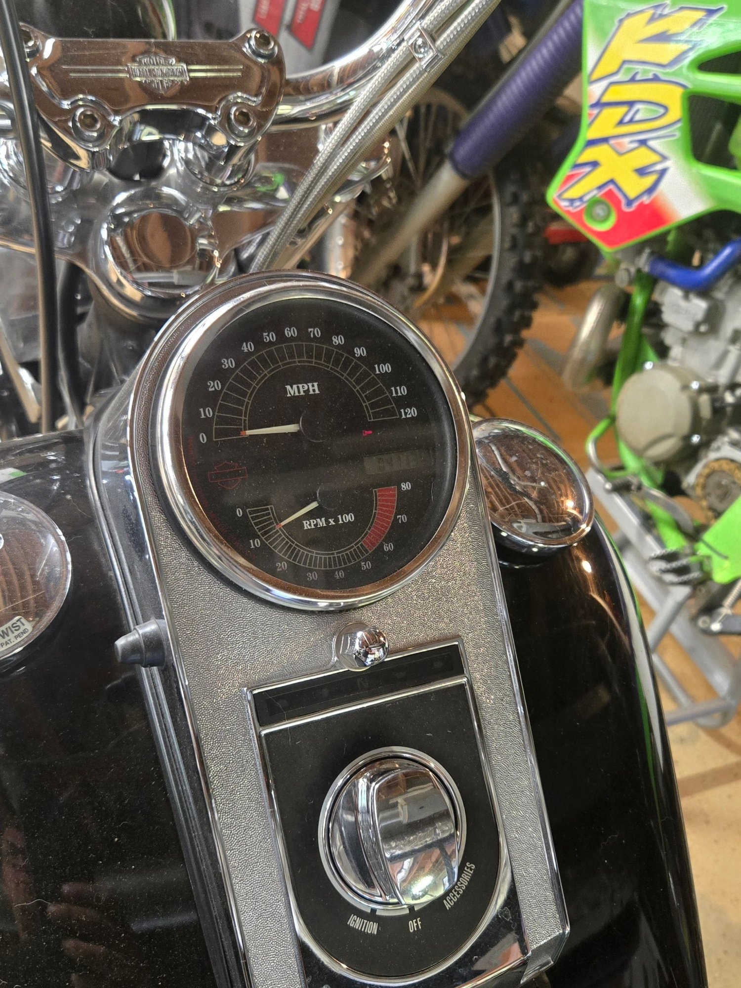

So I have this speedo/tach combo on my 2005 FXST. The tach has been acting wacky for a few years now (speedo works fine), but I haven't been incredibly concerned about it. Used to work fine but then one day it just started doing whatever it wants.
Does anyone know if this is a serviceable unit? Or is there a sensor somewhere that I need to check? There's newer and nicer ones on the market these days, obviously, but I like the look of this one

Check your ground wire connection and tighten both battery terminals. Electronic tachs, speedos are very sensitive to corrosion or loose connections.
