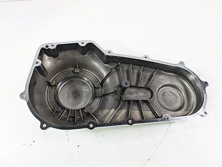

That's a good idea! I believe the bolt holes go all the way through. Pull your loose bolt and check.
If you have a large syringe, that would make the job take a bit less time. Farm supply stores or maybe even a vet should be able to sell you a large syringe. One from a fork oil level kit should work as well.
Tom

Originally Posted by Dispatch
2008 Harley Davidson Heritage Softail Outer Primary Clutch Cover...
I believe I'm correct...
Just take the top bolt out and use a little screw driver to see if the hole is blind or not. Then you'll know.
