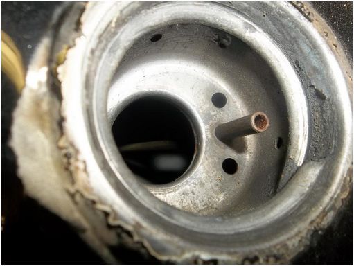

Your pressure relief vent is here? (below)...yes?
Also you can check your vented side gas cap (one-way from OUT to IN) vent by sucking (...really) on the bottom of cap to see if the check valve is allowing air to pass.

How bout this...but again, this isn't your problem.
That's the cross over to stabilse pressure left to right side.

Yep, I could see that when i researched the exploded view of that softail tank. Since the the left tank doesn't use a vented cap, that vent/vapor crossover is the only means provided for the left tank to be exposed to atmospheric pressure. Isn't that left cap also have Left-handed threads? I haven't handled any harley twin/dual tanks (softails), but that doesn't matter...once you know theory, you just apply it wherever you need it.

Yes, left turn tread. This way when filling the tank your not putting the vented cap on the wrong side.
If you've got full tanks or over filled and the bike is on the jiffy stand during the warm weather the gas expands and could leak out the vent if it's on the left side.
