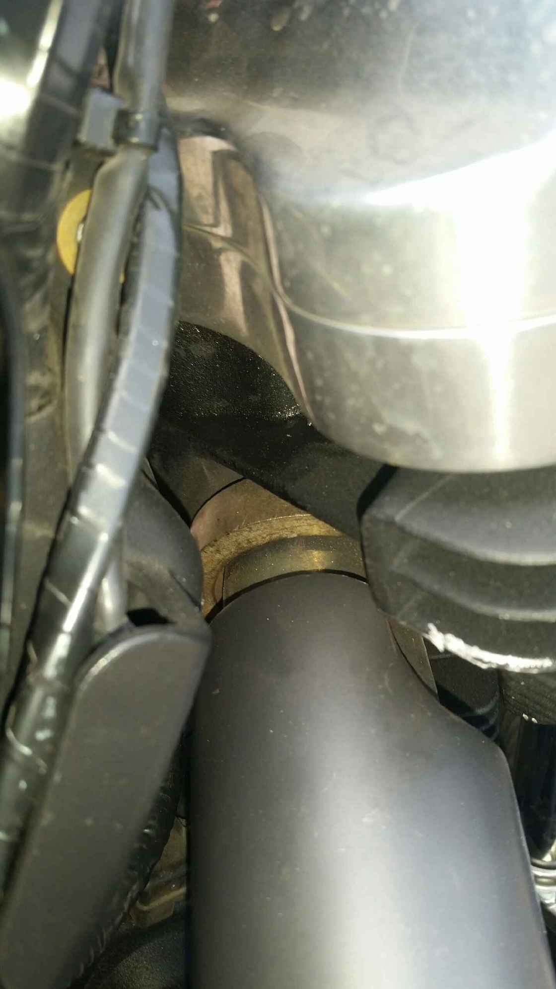

Back of cylinder 2

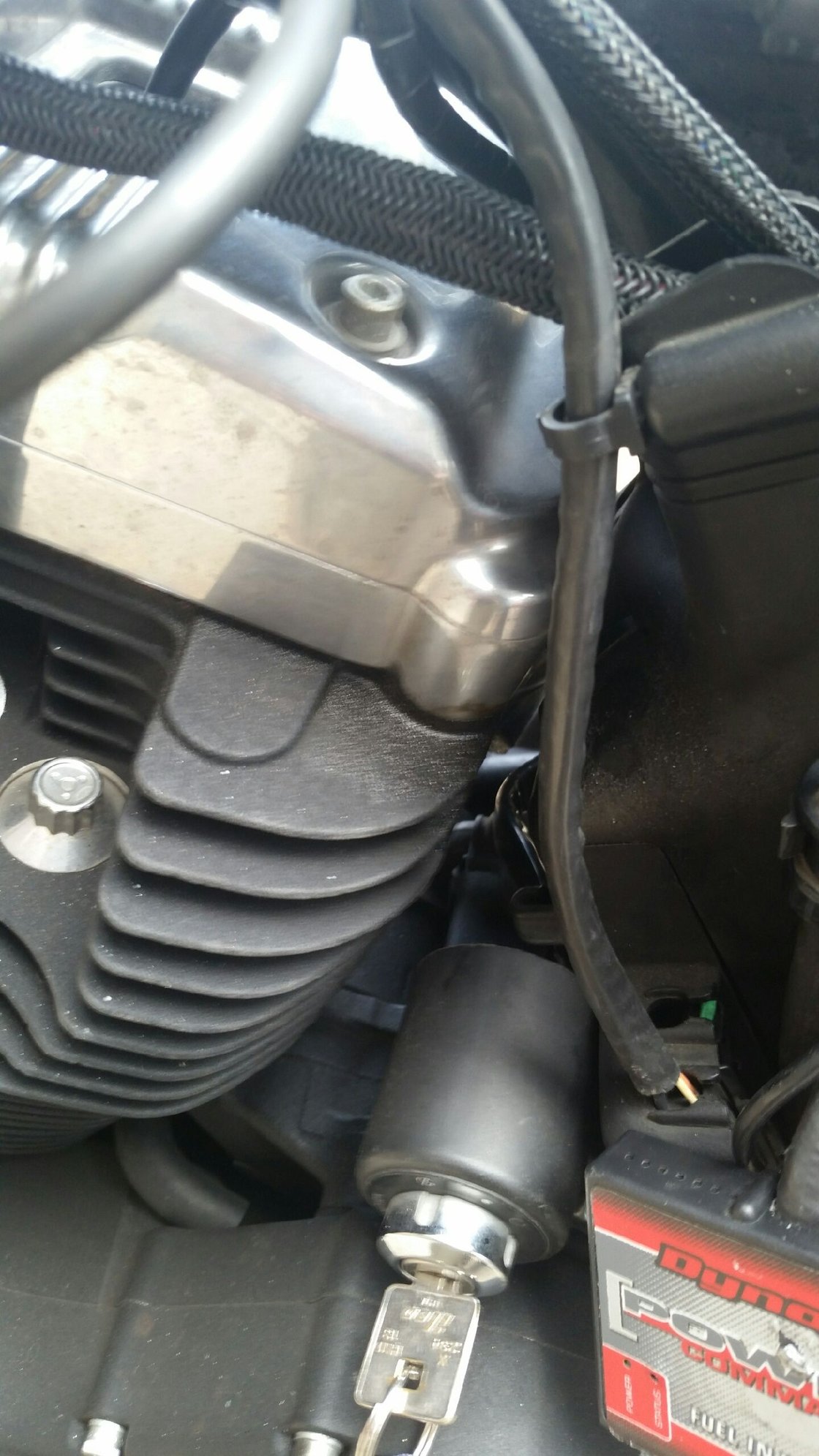

Kickstand side of rear cylinder

The smoke is probably the oil burning off...the oil appears to be leaking from the Rocker cover.
