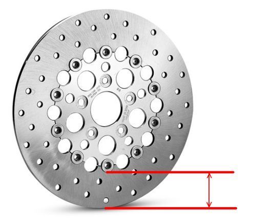

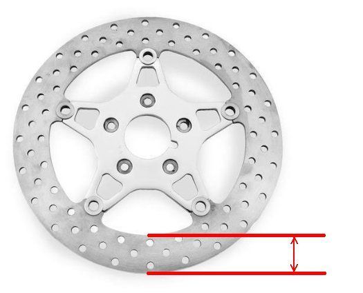

While 2000-later Springers use somewhat unique Rotors, they are many available , but the EBC FSD010 is not one of them
The uniqueness is that they use a 1999-earlier caliper on a 2000-later wheel that has a larger rotor "locator" on the hub.
The concerns are the rotor's brake pad "swept" area. It must be wide enough for your "1999-earlier" calipers also used on 2000-later springers.
So...This is is too "skinny"
But This is Good

Yeah, the Wide-band should work. I previously just grabbed a generic EBC rotor photo (must be a narrow-band). Now that i looked up a actual FSD010 in the catalog, I see it's a wide-band and also listed for your FLSTS.
What's the problem?
EBC apparently made it wide enough so it works for the 1999-earlier pad sizes as well as the 2000-later.
Harley doesn't do this for most of their OEM rotors...for example, you couldn't take a OEM 2000-later non-floating rotor, let's say off of a std Heritage and install on your springer and expect to have full pad contact. Your pads would "hang off" towards the inner radius

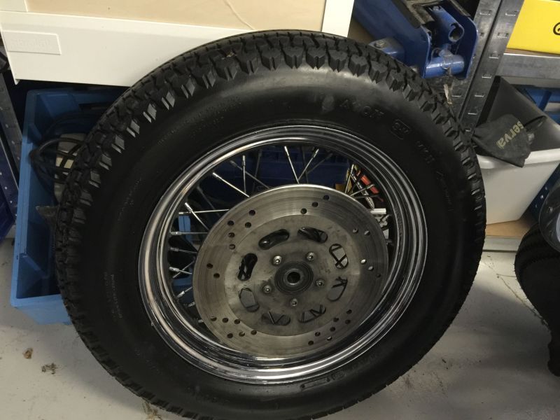

The 2000-later OEM front rotors for springers are somewhat unique (see photo below)
Has the appearance of the everywhere-everyday 1999-earlier brake disc, but with the 2000-up larger ID hole for sealed bearing hubs.
That's why the "-00" part #
