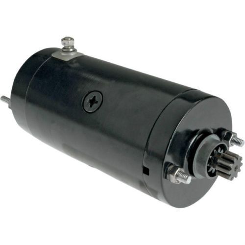

I need a whole new setup for my sportster and im confused on what style i need. Ive seen the long ones as well as a "double decker" one (ill attach images), which one would fit my bike? also if its the double decker, would i also need a solenoid and relay or are those built in?

A complete is part # 31390-86

The parts microfiche shows a piggyback type starter, this type combines the solenoid and motor in a single unit.
You would still need a starter relay.
