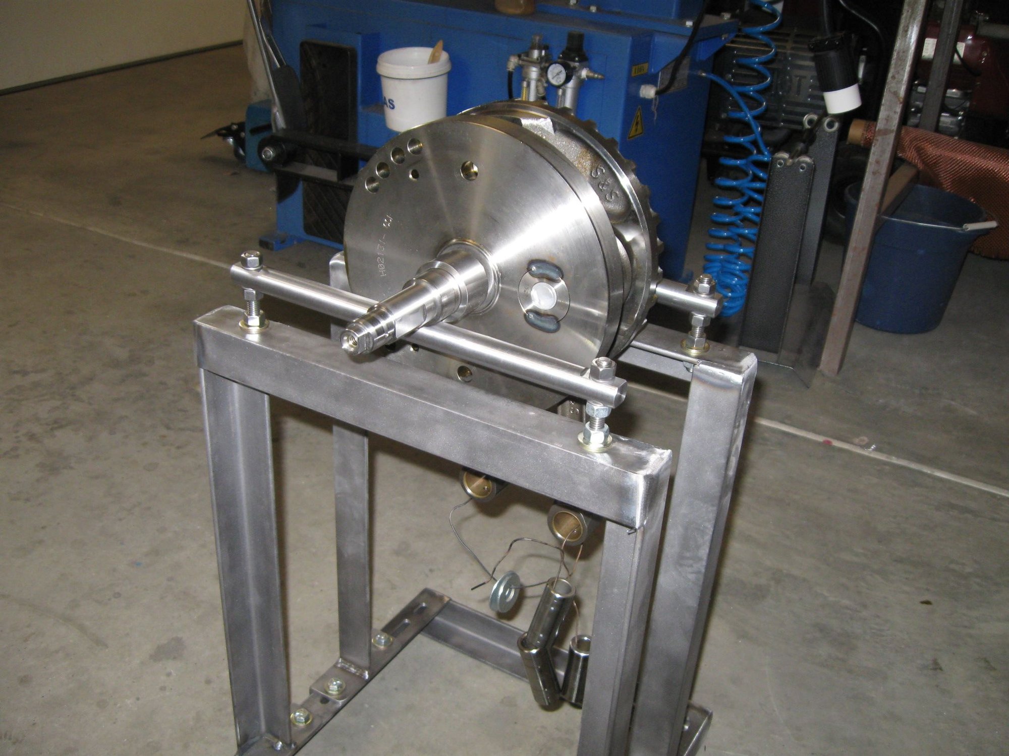

While I have used a lathe to check runout, I don't true in the lathe. Don't want to beat on the lathe. Usually pull the wheels out to check beat on them.. Not sure how you balance in a lathe. Always used a balancing fixture..
Used to cut the heavy sides on pans and shovels then re-balance the halves.. I've only done pans shovels and knucks.
Here is a pic of the a balance checking fixture I did for twincams..

How come my welds never look like that?
Cuz you don't own a 4 1/2 inch angle grinder with some 60 grit flap disks?
