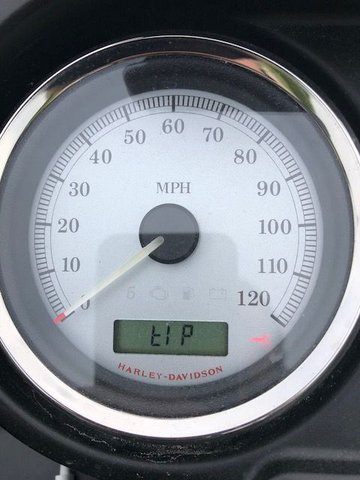

I have a 2010 Road Glide and every
time I hit the throttle hard in 1st gear or 2nd gear my bike dies and throws up this code. I can throttle hard in any gear after 1st and 2nd with no issues. After it dies I have to turn key off then on then restart.
Any help would be appreciated.
Thanks in advance

FYI if I just take of normal from stop it does not die ONLY when I hit the throttle hard

throws up what code?

The one in the
"tI P"

believe it to be a tip code, like the old bank angle sensor code. i believe it to be part of the TSSM module. bt are not my expertise but i believe there were a couple of TSSM's and they had diff orientations. has it been changed or moved??? the machine senses a tip over and kills the engine.

a TIP code?
maybe........some models have a sensor that triggers the ignition off if it falls over a certain degree........could be malfunctioning ....got a FSM?
Ya might start there and see where it is...........

That was it. The TSSM was positioned incorrectly. I put in a FBI drop seat kit and I had the TSSM facing the other direction. I turned it around made sure it was straight up and down it fixed the issye.
Thanks all who replied.
